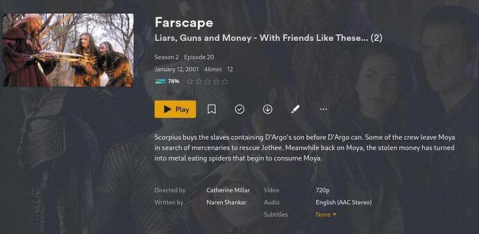

I upgraded to server 1.41.1.9057 the video codec information is missing from both Plex for Linux and Dash apps but is present via https://app.plex.tv and current android mobile app. See below:
Plex for Linux - Video reported as 720p:

This is an odd one as Plex for Linux and app.plex.tv should have the same underlining client code. Anyhow …
To none of my family, wouldn’t mean anything to them, looks cleaner too. I like.
BTW… outside of clients, dash and the dashboard is also missing this codec information now …
All three here are missing the original codec information and just so its not consistent its included in the transcode information in the last example.
I could maybe be convinced removing it from the clients is a good thing but certainly not from dash or the dashboard. Also, if its intentional to remove this then why does it remain for the audio ?
