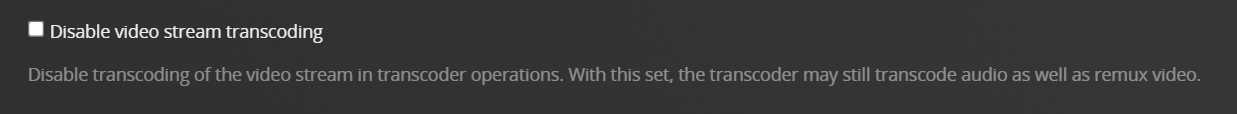

Did you turn off the option to transcode?
I didn’t, all my settings did not change from before the swap.
As a test, i turned on/off transcoding, hardware encoding, etc.
Obviously direct playing works fine and transcoding of audio works fine, its only when it transcodes the video that it craps out.
I feel like it may be ignoring that setting.
Like right now w/ that setting unchecked, I get “This server is not powerful enough to convert video.” when I playback in Chrome.

btw, i did turn Disable video stream transcoding on/off to test
Your preferences show that you have that setting enabled so transcoding is turned off. Are you hitting save when you toggle that setting?
correct, I turned it “on” to see if there was a different error.
When my cousin tried it, it was “off” thats why I mentioned messed w/ the setting.
I need to see the logs with it “off”.
