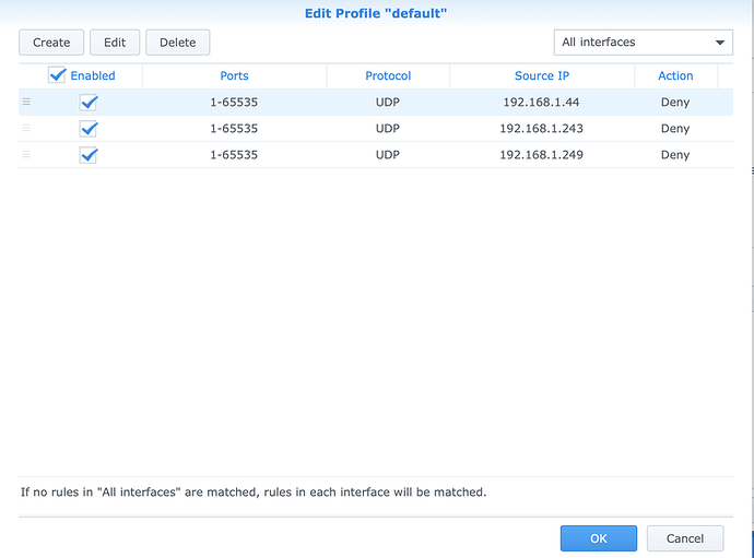

I added a firewall rule to my Synology NAS to block all UDP traffic to the IP’s of my firestick 4k’s and my android TV. That was the only way I could resolve it.

@manish_vallabh_mv_gmail_com , I tried the same but no luck. can you explain or show which Firewall rule you did set in your Synology ?
I did block port 9080 of protocol UPD for both, source and target of FireTV stick IP , but still do ge t below messages every 30 seconds in PLEX MEDIA SERVER.log file

You have to block all ports, for UDP to the IP of your device. I have 3 devices which were generating the same error. Ports 1-65535/UDP Source IP is the device which is generating the error. and choose Deny..
Hope this helps.
