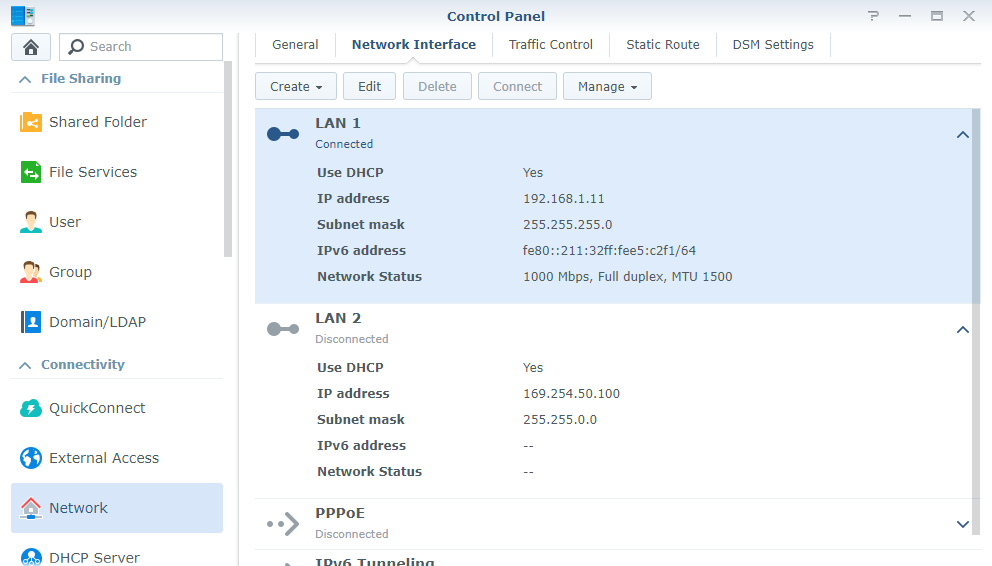

Disconnect the cable from eth1 and leave it connected only to the one with IP .11
eth1 is not connected.
It’s not getting any IP, but it’s definitely connected.
eth1 (169.254.50.100) Using APIPA
Just to make sure run sudo ip link set eth1 down, then restart Plex and check if UPnP configuration works.
Hmm, I can tell you it’s definitely not.
DSM:
And just checked PMS, it only sees eth0. Is there still a point in running the command?
Didn’t know it was a nas. I don’t think the command will work then. Just shutdown that interface because Plex is seeing that interface as active
NetworkService: Browsing on interface 169.254.50.100 on broadcast address 169.254.255.255
Ok well the command still worked, and LAN 2 has now disappeared from DSM. I assume if I ever need to enable it again it’s just sudo ip link eth1 up?
