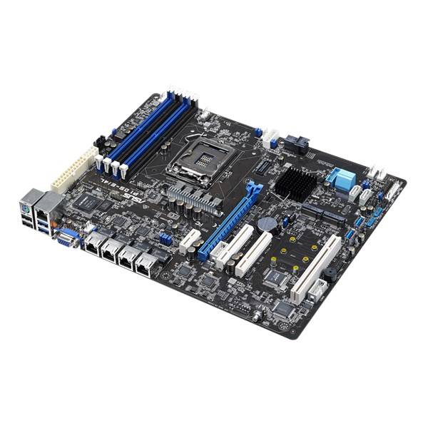

Regarding the motherboard, it does indeed have C236 chipset:
Output from lshw:
description: Motherboard
product: P10S-E Series
vendor: ASUSTeK COMPUTER INC.
physical id: 0
version: Rev 1.xx
@drmagoo This is a server with no X, so I can’t run vainfo.
Not sure what “iGPU” is, The closest to a GPU on this system is the intel graphics embedded in the Xeon CPU, there is no dedicated graphics card.
Sure you can. sudo vainfo will tell you about the availability of the vaapi endpoints on your system. This IS Plex hardware transcoding on Intel. If sudo vainfo is unable to find support, Plex won’t either. Where did you find the information that vainfo is dependent on X :smile: It uses the DRI (direct rendering interface) to talk to the Linux kernel intel module. Just like the X driver does.
The P10S-E comes with Aspeed AST2400 with 32MB VRAM graphics. It does not support the integrated GPU (iGPU) of your CPU. So no Quick Sync, Linux vaapi, with this system. Sorry.
The P10S-M boards for example support Quick Sync. It’s written in the fact sheets:
yeah, not necessarily true. The AST2400 is just the IPMI iKVM, it can be bypassed the same as any other linux machine bypasses any other onboard/offboard graphics to allow QuickSync. (aka, it can be set to be a secondary adapter) Maybe Asus is doing something weird and specific with this board, but an AST2400 alone wont cause any issue.

My last info with this board is that it does not support the intel GPU at all and does not make it available to the OS. E.g. it does not provide any external ports for the iGPU. So, I am very sure that you cannot use Plex hardware transcoding using the Intel GPU in your Xeon. So I am out of this discussion. Please ping me when you have found a solution so I can learn :slight_smile:
I had to contact my vendor to get them to add the option to enable the iGPU inthe BIOS. Do a lspci and see if the intel gpu is enabled!
My board is an ASRock E3C236D2I
Thank you for that input @n0ahg
I suppose I can try giving asus support a try, could you reply with your output from lspci that shows iGPU?

The line you need above is
00:02.0 Display controller: Intel Corporation Sky Lake Integrated Graphics (rev 06)
My board has no way of connecting a output to the onboard video but the iGPU option is now in the BIOS which enables the above PCI device and I’m running Plex in docker with hardware acceleration enabled. Be aware though that the iGPU is now the primary display and used by the BIOS and bootscreen and therefore you have to get used to using IPMI over serial :wink:
after the BIOS update to the most current BIOS, two new lines appeared in lspci
00:13.0 Non-VGA unclassified device: Intel Corporation Sunrise Point-H Integrated Sensor Hub (rev 31)
00:16.1 Communication controller: Intel Corporation Sunrise Point-H CSME HECI #2 (rev 31)
vainfo still returns fatal error, and no iGPU in /dev/dri
so no luck yet it seems, I’ll see what asus will respond to the support ticket, in the meantime I have ordered a P10S WS which should work for sure ™.
Yeah, still no iGPU though. Good luck with Asus, ASRock were pretty good and provided me with a Labs BIOS until they released an official update including the option to enable the iGPU!
Well, after a lot of back and forth, ASUS finally gave an honest answer:
"I am sorry, but it is worthless to discuss about this point.
On this MB iGPU is not supported.
Even in case the limitation would be BIOS only, it would make it necessary to create a new one with support included.
But this will not happen"
So ASRock 1 - ASUS 0 when it comes to support. I supposed a preferred vendor change is in order…
