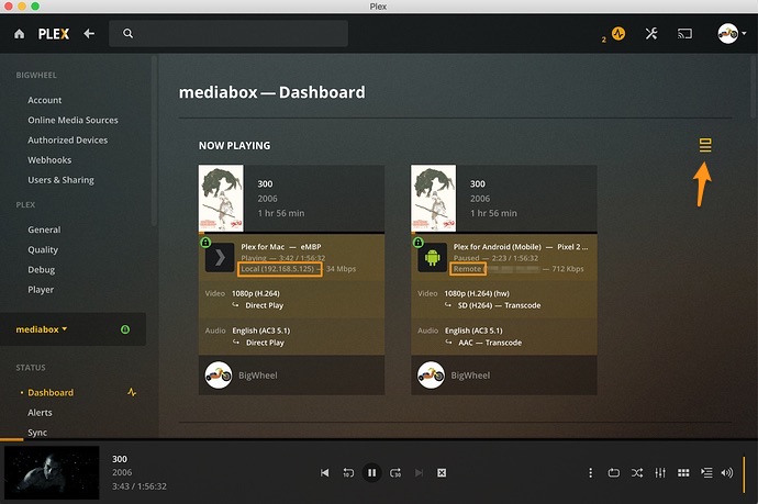

The Easiest way to tell if you’re remote or local would be to play something on one of your in-home devices, then go to settings>dashboard, and in the little graphic it says remote or local next to the IP address

All users free and Plex Pass have the “Now Playing” block on the dashboard. When you open up the individual stream info blocks by clicking on the button on top right (arrow is pointing at in image) local streams will say local. remote will say remote.
