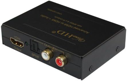

Depending on what your content audio is using, you could use an HDMI audio splitter and run the HDMI to your TV and the Optical to your soundbar. You’d be limited on PCM sound, but you’d be able to play DTS and AC3, etc on surround sound. The SPDIF connection only supports 2.0 uncompressed PCM channels though.
So any content that your sound bar doesn’t support would get mixed down to stereo.
