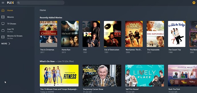

I am having the same issue. I removed that version and reinstalled 1.26.2.5797. All was good. The server then automatically reinstalled 1.27. I have done another rollback to 1.26, however now it only shows my Recently Added Movies, but no Currently watching or Recently added TV Shows.

I am running 1.26.2.5797. It seems like the corruption has been cleared up, but looking at the home screen is missing the Recently Added TV Shows and Continue Watching. I can access the Movies and TV Shows from the left menu without issue.

I tried upgrading to 1.27 and everything came back. Tested playing and everything seems to be working correctly. Thank you for everyone’s help with this.
