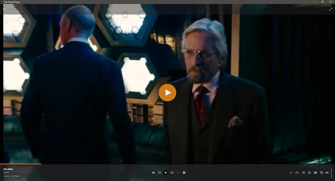

I’ve tried to attach a quick screenshot of a video to give a better example of what I’m experiencing. This is a 1080p MKV at about 4Gb file size. The raw file looks crystal clear, but this version through Plex is very poor.
The other thing that is very odd and makes me believe it is something to do with how I’ve configured it, is that the quality doesn’t seem to change when I adjust any of these settings. It makes me think that they are somehow not applying, or that this is truly as good as it will get.
