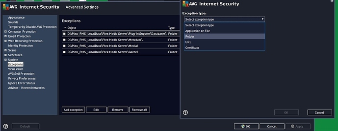

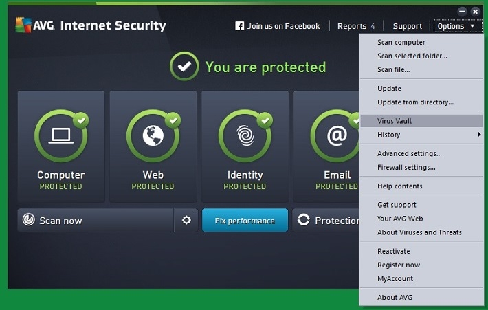

instructions on how to whitelist Plex Media Server binaries within AVG
  1. Open AVG and click on Options and select Virus Vault in the drop down.
  2. Select the quarantined Plex Media Server binary / binaries and any associated registry entries - they would all have the same date and time for the quarantine action and click on Restore. At the end, Close the window when the action is completed.
  3. Then select Options again and Advanced Settings from dropdown and select Exceptions and Add exception and select Exception Type Folder
  4. Then click on Browse and drill down to this path C:\Program Files (x86)\Plex\Plex Media Server and with Plex Media Server folder selected, and ensuring all options ticked - including Identity Protection, Click Apply
  5. Then you will see the folder added as an exception. You should be able now to start Plex Media Server
