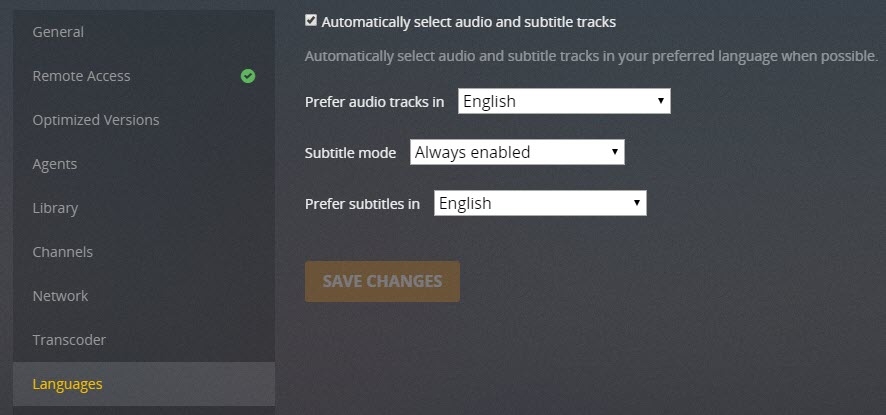

A work around could be to download a srt file, name it the same as the show, and put it in the same folder. I then set Automatically select audio and subtitle tracks and set Subtitle mode to Always Enabled.
Once that was done when viewing a show with a srt file present I get an indicator that subtitles exist.
