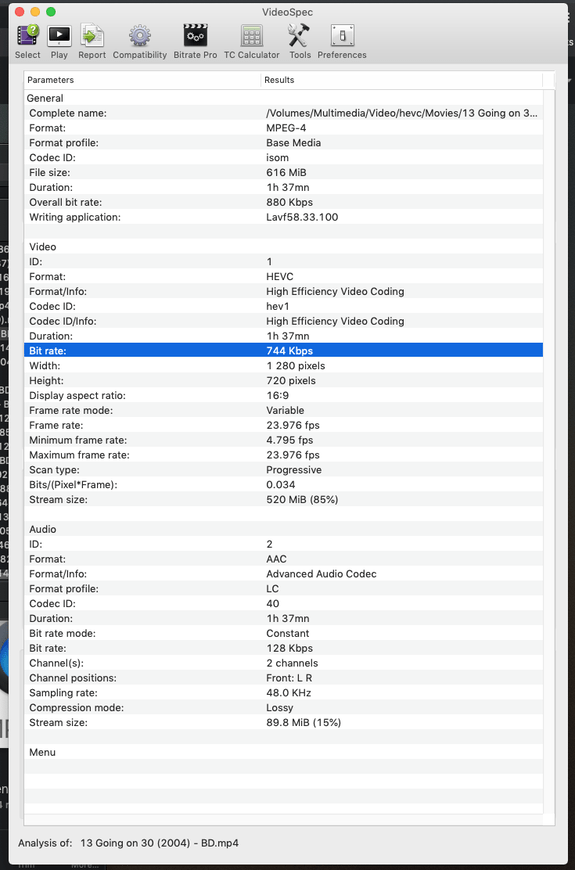

But I have triple-checked and the file is No where near 1769Kbps. I have attached a screenshot.
The overall bitrate is 880Kbps. Even if I allow a 50% variance, I only reach 1320Kbps that fits comfortably into the allowed 1600Kbps.

MediaInfo can/may provide a more detailed inspection, particularly Bandwidth - that may not be in the XML - I really don’t know, but it’s worth a shot.
(you’ll do well having that anyway)
Thank you. I appreciate the link. It shows the exact same numbers as VideoSpec. :slight_smile:
Create a report (Export) from MI and attach it here - just for completeness should someone important come along…lol

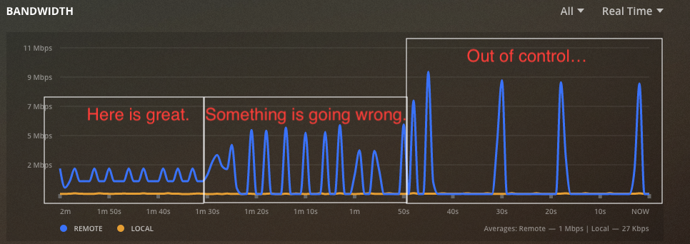

Here is a snapshot of my server with the bandwidth “spurts” I was referring to…
The video played very well on my remote. At first everything is great, and my local download is not affected. Then the spurting starts, and finally big spurts that completely destroy my download bandwidth. When the upload looks like the right side of the graph. I cannot do anything involving downloads. The video continues to play fine though.
I did not have any bw controls set on the server for this test.
Thoughts?

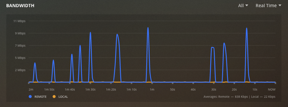

I am still looking fir the correct answer, but wanted to update this thread to let you know that I found something that is working.
My router does not have this feature as an upload option, only download. :-/ However, I found WonderShaper (The tutorial on that page is out of date, but the readme is pretty good.). Anyway, I installed it on my Plex server and did some speed tests per the instructions then set the values and it seems to be working. I did not set any BW limitation in Plex.
Here is my new screenshot:
The peaks are still way too high, but for at least this test, it is working great and not impacting my download speed.
I am still really interested in doing this the correct way. Is there a tag I should be looking at? I posted the xml file above. :slight_smile:

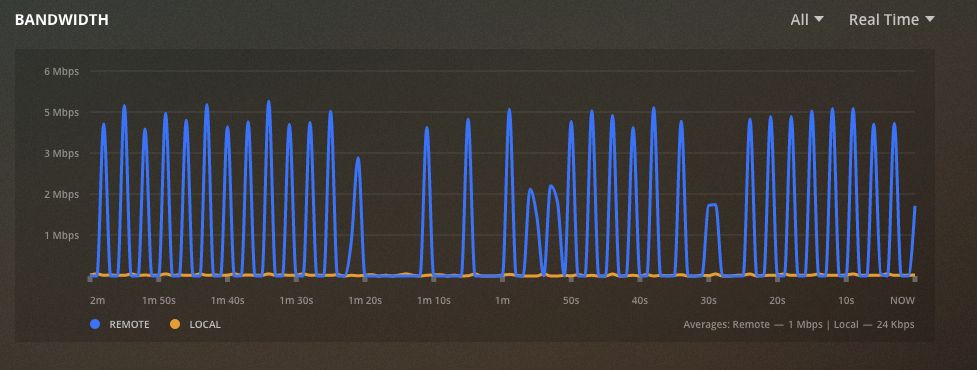

Well I guess I spoke too soon. I think this would work great if I could control all of my network through Wondershaper, but since it only controls the Plex server when I do a speed test (upload) from another machine it saturates the upload part of the network and then Plex starts spurting again. See here:
This then results in the download being completely unusable. I have to stop the video and restart to get the spurting to reset.

In general I think what is happening is that you are seeing more level network use while the buffer is filling on the client (which may continue even after playing has started.) Then when the buffer is full it starts transmitting in chunks as needed, so you get spikes when chunks are transmitted and nothing while the client is happy playing from it’s buffer.

Ya, that seems very likely. I just cant figure out why it is peaking so high. When I limit to 2.2Mbps, it still peaks over 5, unless the graph in Plex is not accurate. BTW, 2.2 seems to be the sweetest spot.

Keep in mind that without setting a bandwidth limit in PMS, a client will try to download as fast as your network will allow. So what you are seeing is normal and expected. If you need to limit your throughput, you will need to setup a limit in PMS or control it outside of Plex with your router’s QoS or a 3rd party program like you tried. I’m not sure why it is triggering a transcode. Your XML looks fine. I’ll need to see your PMS logs after recreating the issue. You can PM me the log if you don’t want to share it publicly.
