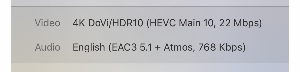

This can be seen in a single file which has two audio tracks, e.g. TrueHD and DDP. With DDP selected, DV successfully activates. With TrueHD, audio transcoding is required and DV does not activate.

Same file, same unaltered video stream in both, just different audio tracks; the first doesn’t activate DoVi on the LG set, while the second does.
