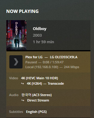

But when I try to play Oldboy (2003) Plex always transcodes the video and removes Dolby Vision, even if I select “Original” quality. Can I turn this off somehow?

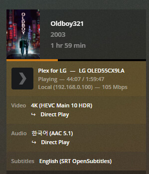

Edit: okay this is highly confusing to me. Now that I know that the subtitles are causing the issue I was able to find this thread which seems to imply that I need to convert the audio to a format witch can be direct played and then chose SRT subtitles, is that correct?
Yes, that seems to work.
AC3 is a supported audio format on LG. It is direct playing in your original screenshot. There isn’t really any difference between direct play and direct stream as far as how it’s being played back. The only reason it says “direct stream” is it cannot be direct play if the other components of the program (the video and subs) are not. You don’t need to convert it to AAC.
The only issue here is the LG cannot natively play image-based subs like PGS. Using SRT is the only change you need.

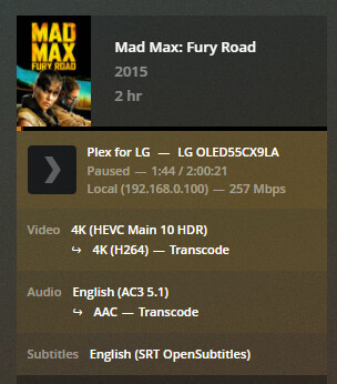

I’m not sure why, but AC3 only seems to work for stereo tracks (the original screenshot was playing the director’s commentary). If I chose a AC3 5.1 track it transcodes to AAC.
