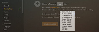

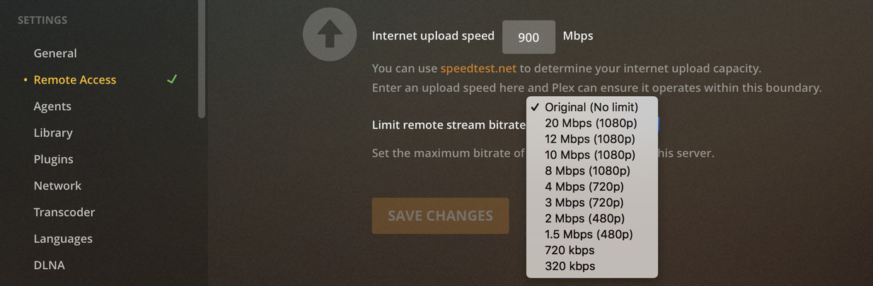

EDIT: I’m specifically asking about the remote quality menu which, for me, stops at 1080p. Or if I set it to Maximum that would include 4K? If so, it should say that.

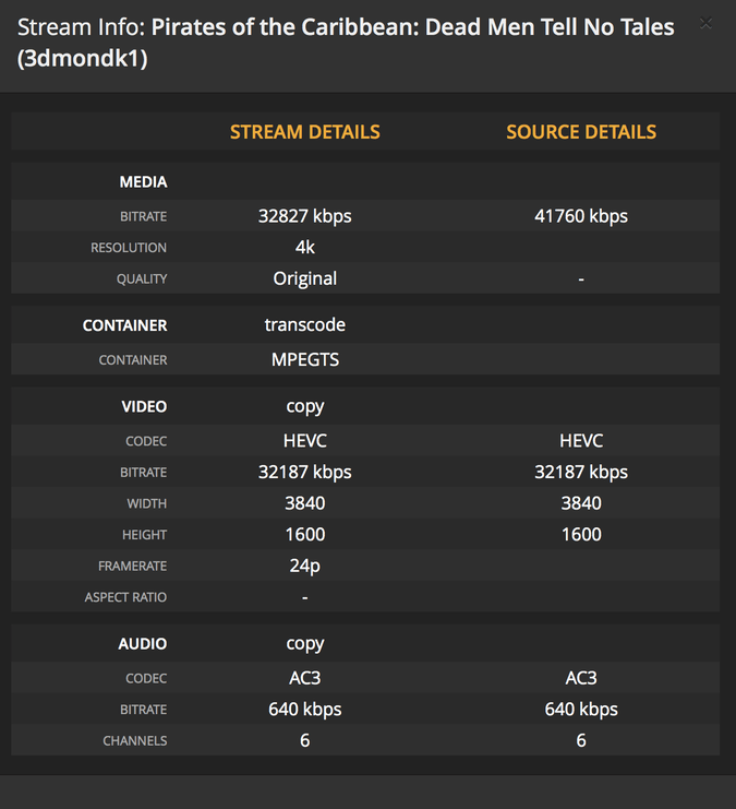

Remote streaming of 4K content on Plex is currently possible, I share my Plex account with multiple family members and they have been able to stream my 4K movies with no problem at all (see screenshots below).

I updated my post with a screenshot - I don’t see 4K listed there, so I assumed it wouldn’t do it. Does Maximum = 4K?
essentially yes.

Yes, the Maximum setting will allow playback of 4K video. We do not have a setting to transcode 4K to a lower 4K quality. So right now, it is either 1) direct play or 2) transcode 4K to 4K at the same bitrate or 3) transcode to one of the available settings shown.
Setting up your web quality to Max (see below)
And setting your remote access quality to Original (see below)
Should essentially allow your remote user to playback your 4k files at their original quality.
