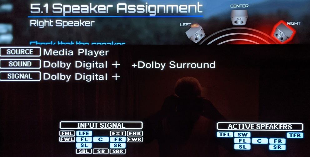

Here’s an example:
Playing a video with dts 5.1 audio on my FireTV stick 4K. FireStick audio = Best Available. Plex app Passthrough = HDMI.
Plex media server reports direct play.
Denon on-screen display shows it is receiving Dolby Digital Plus 5.1 (Signal).
Edit: dts-HD MA 5.1 and dts-HD MA 7.1 act the same as dts 5.1. Guessing that only the core dts 5.1 is processed and the “-HD MA” part is discarded.
FireTV Stick 4K <-HDMI-> Denon AVR-X4300H <-HDMI-> LG B7 OLED

I can’t understand why your receiver receives the DD+ audio? In your explanation, it should be the DTS core.
By the way, is there any chance to show DTS-HD MA direct play in the plex sever dashboard?
It shows DD+ because the FireTV transcodes the audio to DD+ before sending it to my receiver.
It does. I was playing a dts, not dts-HD MA, audio stream when I took the screenshot.
