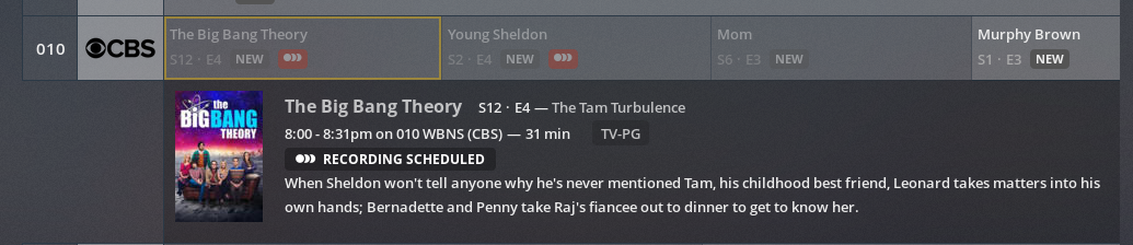

As you can see below, The Big Bang Theory was new and when you expand the listing in the web client it says that the recording was scheduled. (Live TV & DVR -> Guide)

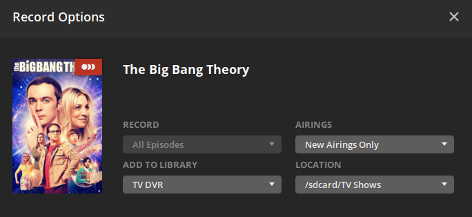

As you can see, I have it set to record:
NOTE: I do have it set for New Airings Only, but if you look above, it does indicate that The Big Bang Theory is new
