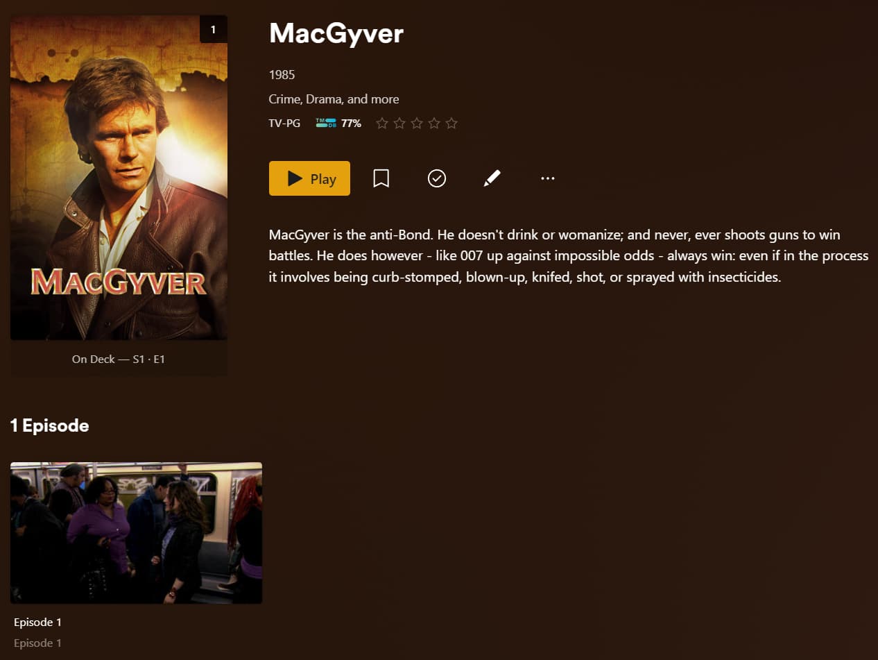

As @ChristianKent suggested I used the TheTVDB ID in my .plexmatch file (instead of The Movie Database ID).
tvdbid: 77847
# tmdbid: 2875
I’m using MacGyver as an example. :slightly_smiling_face:

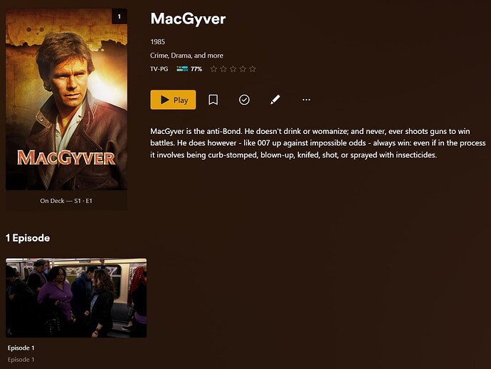

After adding:
As you can see, episode metadata is missing. Metadata for the show is found.

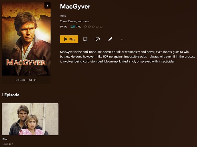

If I select the show or season and perform a “Refresh Metadata”:

Oct 22, 2024 17:55:47.938 [139856763607864] DEBUG - [Req#2c89e2] Activity: registered new activity 74d28df0-a887-4421-b4fa-5fd040fc743c - "Updating Metadata"
Oct 22, 2024 17:55:48.349 [139856763607864] DEBUG - [Req#2c89e2/HCl#8542] HTTP requesting GET https://image.tmdb.org/t/p/original/oXlghBNIsbbYGMjrcEn769ECpWp.jpg
Oct 22, 2024 17:55:48.711 [139856763607864] DEBUG - [Req#2c89e2/HCl#8543] HTTP requesting GET https://image.tmdb.org/t/p/original/e2XDTN8HGA8NnM3hlJiIbMiaAHk.jpg
Oct 22, 2024 17:55:48.755 [139856763607864] DEBUG - [Req#2c89e2] Loaded metadata for Pilot (ID 559533) in 51ms
This time season poster and episode thumbnail (and info) is downloaded.
