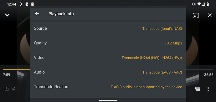

I’ve been having some weird issues with playing some files on my Phone. I’m using a Google Pixel 4 and watching a 1080p H.264 mkv with EAC3 audio always results in full transcoding.
Looking at the playback info on the phone it seems that Transcoding is being done because E-AC3 is not supported by the device, but then, why is it not Direct Streaming the video and just transcoding the audio? Playing the same file over Plex web is successfully direct streaming the video and transcoding the audio (as Plex Web on Chrome also does not support E-AC3 audio).
I seem to rememeber that it is done because the synchronicity between video and audio cannot be guaranteed in this particular constellation.
Constellation?
You mean the ExoPlayer in the Mobile Player cannot stitch the audio and video back together properly?
Is there any workaround to this? I seem to remember that the Androdi TV app uses ExoPlayer2, is that available for the Mobile app?
Unfortunately, the workaround would be to transcode the audio beforehand and then mux it into the MKV as the first audio track.

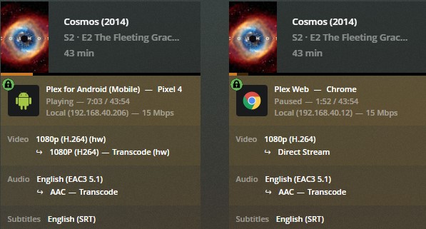

These are the two examples that made me believe that EAC3 is the reason for complete transcoding, and not the High Profile… (though one is L4, the other is L4.1, but the limit on the phone is 5.2)
Morning.txt (4.4 KB) Cosmos.txt (4.5 KB)
Cosmos:

It could be the reference frames. I believe the limit for 1080p content is 4.
Yes, this video stream is invalidly tagged. Plex will store the actual H.264 level (which would be 5.0, AFAIR), into its database during the stream analysis.
So if you look at the Plex XML info of this video, it will tell a different story.
5 ref frames is pushing the envelope - maybe enough for your finger to poke through on a phone, but I’ve never had an issue with 5 on anything else. I don’t encode at 5 for 1080p, that’s certain:
https://forum.videohelp.com/threads/348660-H264-Profile-High-4-1-with-5-Ref-Frames-!
The device is authorized to (try and) play L 5.2 - that’s not saying it can actually do it.
The actual level of the material is 4.0 and 4.1 respectfully and the 4.1 is the one with 5 ref frames - not perfect, but not horrible - if the phone can play it.
Indications are the phone won’t play E-AC3.
Mine won’t.
I’m not surprised.
Mine will play 1080 @ 4.1 with 5 ref frames, but E-AC3 is right out.
Actually it seems that Plex XML backs up the mediainfo dump.
<Media id="1205" duration="2635784" bitrate="10544" width="1920" height="1080" aspectRatio="1.78" audioChannels="6" audioCodec="eac3" videoCodec="h264" videoResolution="1080" container="mkv" videoFrameRate="24p" videoProfile="high">
<Part accessible="1" exists="1" id="1207" key="/library/parts/1207/1585080184/file.mkv" duration="2635784" file="/share/Video/Docu/Cosmos (2014)/Season 2/Cosmos.Possible.Worlds.S02E03.Lost.City.of.Life.1080p.WEBRip.x264-CAFFEiNE.mkv" size="3474514788" container="mkv" deepAnalysisVersion="4" requiredBandwidths="17748,16551,13811,12521,12419,12419,12419,12419" videoProfile="high">
<Stream id="4082" streamType="1" default="1" codec="h264" index="2" bitrate="9904" language="English" languageCode="eng" bitDepth="8" chromaLocation="left" chromaSubsampling="4:2:0" codedHeight="1088" codedWidth="1920" colorRange="tv" colorSpace="bt709" frameRate="24.000" hasScalingMatrix="0" height="1080" level="50" profile="high" refFrames="5" requiredBandwidths="17108,15911,13171,11880,11784,11784,11784,11784" scanType="progressive" width="1920" displayTitle="1080p (H.264)" />
<Stream id="4080" streamType="2" selected="1" default="1" codec="eac3" index="0" channels="6" bitrate="640" language="English" languageCode="eng" audioChannelLayout="5.1(side)" requiredBandwidths="639,639,639,639,639,639,639,639" samplingRate="48000" displayTitle="English (EAC3 5.1)" />
So aren’t we back to sqare 1 with the audio being the cause for the transcoding, and the initial question “Why doesn’t the video direct stream and the audio transcode?”
