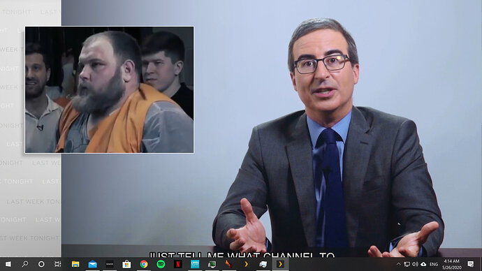

When switched to full screen mode in Plex for Windows app, Windows taskbar won’t disappear and will stay on top of the player. I’ve tried PMP in desktop mode and there are no problems but then the annoying pop will keep telling me “Plex for Windows” is the future app to be used.
I’ve tried searching everywhere to no avail. However there’s an “Keep Plex on top of Windows” which resolved the problem but not sure if this was supposed to be set as it wasn’t set by default. Is this a bug? What’s going on? Reinstalling display drivers didn’t help either.

The issue isn’t that it doesn’t go in full screen mode. It DOES go in full screen mode but task bar will still stay on top. I’ve tried shortcurts, same problem. This doesn’t happen with PMP or other apps so I know it’s an issue with the Plex app.
Please see the image attached:

As you mentioned you’ve seen this in older apps but not the newer versions, this gave me an idea. I’ve set compatibility setting for the app and “Override high DPI scaling behavior” and set it to “system”. I’ve relaunched the app and boom fullscreen working again.
So I had previously set a custom scaling factor for my TV, so I’ve just changed it back to one of preset % values and I’ve disabled compatibility mode. The fullscreen was working again.
So it seems like a bug if custom scaling factor is being used, taskbar may stay on top. Cheers!
Edit: Note that I’m noticing this could be some issue with Windows as well. With custom scaling set, auto hide taskbar setting will still leave top row pixels of task bar visible but the issue is gone again with preset scaling values. Weirdly, Netflix seems ok in either custom or preset scaling.

Replying to the original question, I figured out what the problem is.
So I was using a custom scaling of 115% and then tried setting it to the preset of 125%, and that did work, but the UI elements were too large for my taste.
I also tried out using 120% custom scaling and that also worked, and so did 116%. As it turns out, the plex app can’t handle odd custom scaling percentages.
Btw I have 2 monitors connected and this issue only happened on the second monitor
