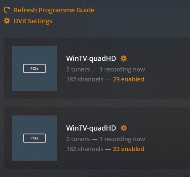

Interesting. My Quad has so far been able to record 3 things at once without a problem. I’ve just checked it now - it’s recording two things and has split them between the two dual tuners :smile:
At 9.55pm today it will be recording 4 things at once so I’ll have a look then and see what it says.
I’ve just tuned a laptop and a TV to watch different channels and it is working fine, see the below :smile:
