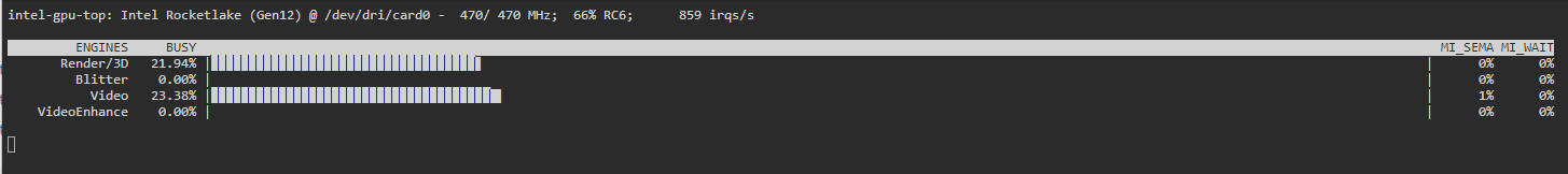

Hardware transcoding doesn’t appear to be working with this combination. intel_gpu_top shows no activity and the transcode section on the dashboard doesn’t get the (hw) listed anywhere.
I pushed the latest container with tag 20678 is anyone else wants to try it. I’ll poke at it some more later too and if anything changes i’ll update the post.
Just rolled NEO back and still no activity on the GPU. I’ll roll the kernel back next to make sure i see activity then try the latest neo again.

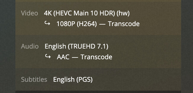

Plex shows the hw mark for me.
Screen Shot 2021-08-20 at 3.40.26 PM
stream info
copied from plex “file info”
Duration 1:43:13
Bitrate 79050 kbps
Width 3840
Height 2160
Aspect Ratio 1.78
Video Resolution 4K
Container MKV
Video Frame Rate 24p
Video Profile main 10
Codec HEVC
Bitrate 60669 kbps
Language English
Language Tag en
Bit Depth 10
Chroma Subsampling 4:2:0
Coded Height 2160
Coded Width 3840
Color Primaries bt2020
Color Range tv
Color Space bt2020nc
Color Trc smpte2084
Frame Rate 23.97599983215332 fps
Height 2160
Level 5.1
Profile main 10
Ref Frames 1
Width 3840
Display Title 4K (HEVC Main 10 HDR)
But I do notice a 300% CPU usage while playback.

newbie question but whats the command to see the full line item log for intel gpu top?
i ran intel_gpu_top in command line but only see this:
