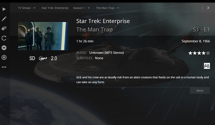

Folder Structure:
Star Trek Enterprise
Season (number)
File name format example:
Star Trek- Enterprise.S01E01.Broken Bow
Image below is how it displays.
It has the right artwork and show title.
It has the WRONG episode name, air date and description.
This across the entirety of Season 1-3.
