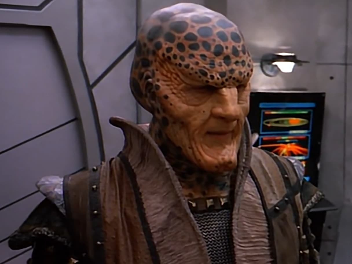

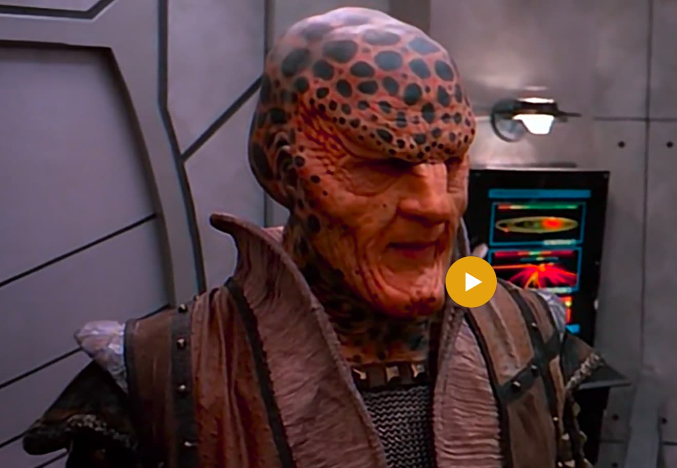

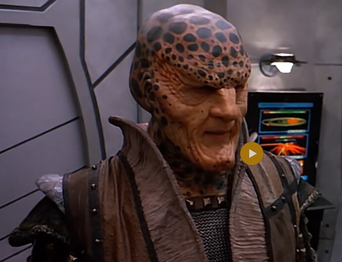

In the Plex windows app the movie is just way too saturated/red, and in the web app and MPC it looks fine. In both plex cases the video was playing without transcoding. (Direct Play)
Plex windows app:
Plex web app:
MPC:

QuickTime and VLC also give results similar to what mpv and Plex produce. This file’s H.264 bitstream appears to have been mis-tagged as BT.2020 when it actually contains BT.709 or BT.601 video. When this is played by a BT.2020-aware player, this means that its colors appear oversaturated.
Players often use BT.709 or BT.601 for content with colorspaces they don’t recognize, so your other players are probably not aware of BT.2020 (or how it can be signaled in H.264), so they’re falling back on BT.709, which happens to look better for this particular mis-tagged file.
The case of BT.2020 in H.264 is entirely valid (if uncommon), and mpv and Plex are entirely correct to support it. If we incorrectly played this file as BT.709, it would happen to look better for this file, but it would produce incorrect output for files that actually are BT.2020 (and similarly, such files likely look incorrect in the other players you tested with).
Please check the tools used to produce your file (or contact the author if it was produced by someone else) and see if there’s an issue with their configuration. As a workaround, you could re-tag this file using ffmpeg’s h264_metadata bitstream filter (see the colour_primaries and matrix_coefficients parameters), though details on how to do so are out of scope for this forum.

That’s interesting. I’m also playing it in latest firefox on windows and as you could see in the 1st post on the screenshot, the web app’s colors seemed ok.

The web app is going to play with whatever decoder your browser uses. Most H.264 decoders don’t understand BT.2020. Apple’s and MPV’s H.264 decoders are ones that do. Assuming your browser’s decoder is in the majority here, then it isn’t playing it just fine; it is playing it incorrectly. Just the file’s H.264 bitstream lying about the color space and the decoder not understanding BT.2020 correctly mostly cancels out (a rare case where 2 wrongs make a right).
Is this using a H.264 decoder that understands BT.2020? I expect not. See earlier in this post.
This is an extremely fringe case. You are likely better off using the suggested FFmpeg bitstream filter to correct the file.
