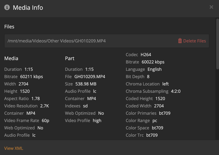

Can you provide a sample of one of the videos that you see the issue with or an XML file for that video?
You can get the XML file by selecting ... > get info > view XML
I`ve attached the XML inside a .TXT file. hopefully this is OK.
lip sync.txt (6.6 KB)
I’ve been trying to reproduce the issue on my end with similar files, but not seeing any issues with lip sync. Sadly, my DVR setup does not record content in that format. Can you provide either a sample of the video or PMS logs after you start playback of the video?
