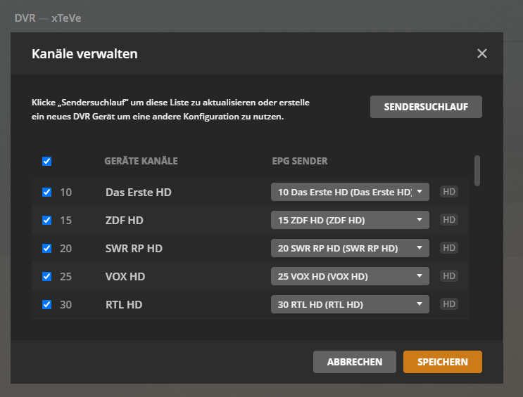

existing TV source, just wont play anything anymore and not updating EPG, deleting the DVR
and readding doesnt help either

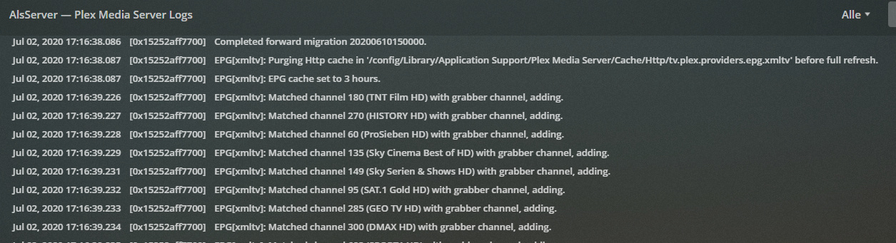

refreshing EPG will not update anything … sample from logs
