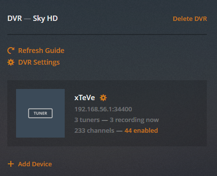

something very strange just restarted it all again and it seems to have forgotten the channels I added as well might try reinstalling plex

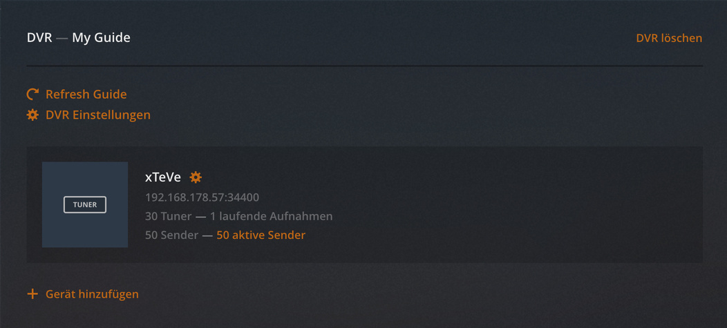

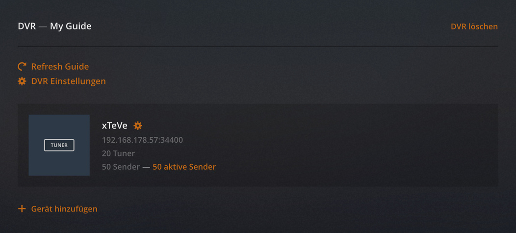

Wait, I’ll give it a try.
Very strange, it works for me :thinking:
I am at a loss I have tried everything, so confused
It seems that Plex is not deleting the DVR when I delete it, so when I restart Plex it loads the old config
Maybe the scheduled server maintenance will help.
so I changed it to 3 tuners to try it then changed it back to 2 and now I have lol
Managed to work it out, i had to add as a different number of tuners restart plex, then load channels, restart plex, then add 2 tuners again
