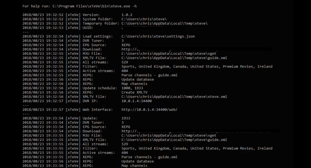

I too am getting a crash whenever xTeVe does an automatic scheduled update of the M3U and TVXML files (manually refreshing them works fine).
I managed to screen record the xTeVe.exe window to see exactly when it quit… it was at this point…
I re-tried several times (by changing the schedule time) and the it quit at the same point every time.
Strangely, I tried using an app (CRP) to re-open xTeVe in the event of a crash, but this just ends with xTeVe in a crazy crashing/re-opening loop. However, if I let it crash and then re-open it manually it works fine :thinking: I can only assume that CRP is re-opening xTeVe too quickly.
Which provider is the XMLTV file?
I found the bug. Today there will be an update, then it is fixed.
