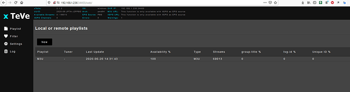

Hi everyone
i am trying to insert my iptv list in xteve without getting any results
I added the m3u file but when I go to look for the receiver and select xteve and as if no channel was loaded
when there are over 60,000 channels as per photos attached
do you know how i can solve it?
thanks
You should be seeing an error in xteve console telling you Plex can’t support that many and, if i remember, i think it recommend filters.
Additionally, the file you are using is probably not formatted like a true tv epg service, but work on first error to start
hi thanks for your reply
in xteve it gives me this error
2020/06/20 14:31:44 [xTeVe] [WARNING] xTeVe has loaded more than 480 streams. Use the filter to reduce the number of streams.
2020/06/20 14:31:44 [xTeVe] All streams: 69013
2020/06/20 14:31:44 [xTeVe] Active streams: 0
2020/06/20 14:31:44 [xTeVe] Filter: 0
so how can I solve it ??
I have eliminated many channels and left only the live and return to the 480 channels

Because you still have more than 480 channels. You cannot have more 480 channels on Plex.
It’s in the documentation
Available Streams: Available streams / All streams
If the available streams are 0, the limit of 480 is exceeded and the filter must be used.
