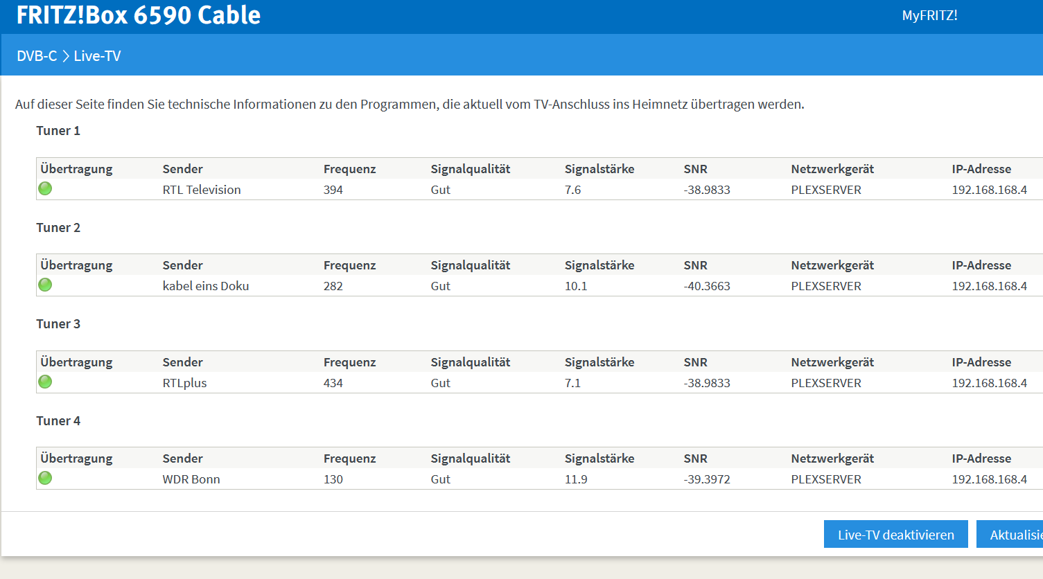

How can I use all four tuners of the AVM FritzBox 6590 Cable with xteve? I configure 4 Tuners but only one Tuner is used. The first recording stops when a second starts, the Tuner change the channel to the second and the first record ends Thanks

The FritzBox only allows one connection from the same IP
Take a look at the documentation, the most important things are described there. There are now a few tutorials on YouTube.
Not more…Plex DVR with the same IP can Records 4 Streams but ist not official supportetd and 1 of 5 records stops with transconder error…since 2019 you can use all 4 Tuners
xteve runs perfect…but only with one tuner… :slight_smile:

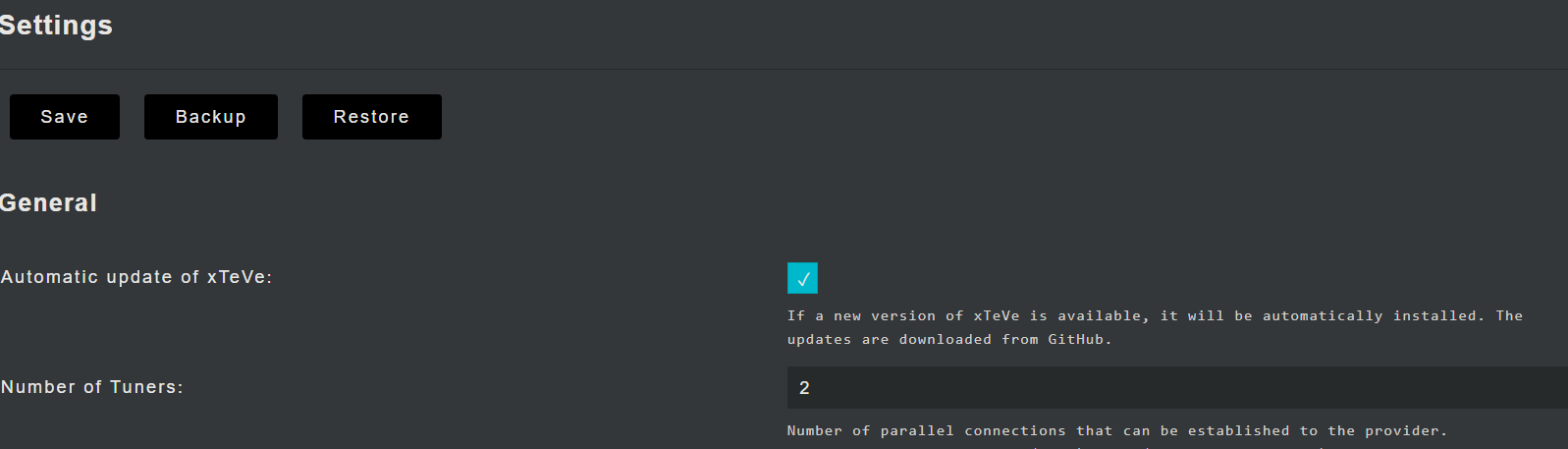

If you have activated the xTeVe buffer, you also have to set the number of tuners in the M3U settings. grafik

Yes i have tested everything. 4 Tuners in m3u 1 in the Settings, 4 Tuner in m3u 4 tuner in settings and 1 tuner in m3u 4 in settings. The Buffer is on and one stream records perfectly…so its okay.
But when a second records start, the used tuner in the fritzbox change the channel and the first record stops after a while … …

Same issus with Ubuntu…only one tuner are used
With VLC oder Plex or other Programs, i can use all 4 Tuners.

I can’t do anything about that. FFmpeg or VLC as a buffer connects to the FritzBox, xTeVe receives the data from FFmpeg / VLC and sends it to Plex.
Each stream is a single FFmpeg / VLC process. 4 streams = 4 FFmpeg processes that connect to the FritzBox.
Mhh okay…
The settings in VLC are okay…i can start 4 streams together with vlc without xteve and use 4 tuner. I think xteve makes a short break when a 2. stream starts…so only one tuner with ne new channel is used.
