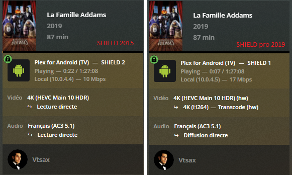

Hello guys, i have a problem with my new Shield TV… it’s not possible to play a movie (4K HDR 10) without video transcoding… yesterday I had no problem with same movie…
No subtitle
Same movie on my Shield 2015, no issu, playing perfect without transcoding
what i tried :
  • Restarted my shield and PMS -> Same
  • Play another 4K -> Same
  • Change old and new player -> Same
  • Reinstall PMS ans PLEX -> Same
  • Factory reset Shield -> Same
  • Read same movie on my old oneplus 3 (PMS on Shield 2019) -> Working perfect without transcoding
I’m tired of testing, I need your help pls

Jul 14, 2020 12:57:35.095 [8916] DEBUG - La Famille Addams - video.colorTrc limitation applies: smpte2084 != bt709|bt470m|smpte240m|smpte170m|bt470bg|bt2020-10 [list]
Jul 14, 2020 12:57:35.095 [8916] DEBUG - MDE: Cannot direct stream video stream due to profile or setting limitations
It appears the Shield Pro 2019, or the display to which it is attached, does not like the SMPTE ST 2084 information in the movie (SMPTE ST 2084 is part of the HDR10/10+/Dolby Vision/HLG standards).

Well it was a great idea !!
The verdict final is, I connected my 2015 shield to the TV or was connected to the 2019, and no transcoding when plmayig movie, which clearly excludes a problem with the TV.
I think i have an issue with player of Shield 2019… not with PMS 2019 because when I playing the same movie from PMS 2019 on the shield 2015, I don’t have any transcoding… → PMS 2019 is OK.
TV1 (Shield 2019) is Panasonic TX48AX630E
TV2 (Shield 2015) is an old Panasonic plasma 720p (yes i do :smiley: )
→ Plex app setting absolutly same
→ PMS setting absolutlu same
→ PMS version same
→ Player version (last same)
some days before, the same animation worked without transcoding problem … :frowning:
I even reset the 2019 shield without success
In shield setting, its approximatly same… (Upscaling desable on shield 2019 but Android TV is in 4K)

Shield 2015 on (Shield 2019 TV)
Shield 2015 on 4K TV
Oh yes, and i try same movie in Plex for kodi (on Shield 2019) and working Perfect without transcoding

as ford guy clearly showed above from the logs, the rip is using SMPTE ST 2084 and the 2019 shield, either alone or in conjunction to your particular tv, does not like this encoding.
You should either re-rip with normal encoding, or send the file back where you got it and get a different one.
  • if Shield 2019 support DV, why doesn’t work ?
  • if 2017 does not, why working ?
With my particular TV, same file working well without transcoding some day ago…
I don’t understand…
And why Plex for kodi working ?
@TeknoJunky ?
while 4k, this tv does not appear to support any HDR
why the 2019 doesn’t like and the 2017 does, I do not know.
as for why it may have worked before, I couldn’t tell you, other than to suggest you might have thought it worked but didn’t, or maybe a different file was downloaded, or maybe there was some android update.
without logs from before and after, its really impossible to say.
though the current logs say, it doesn’t like that encoding, for whatever reason.
