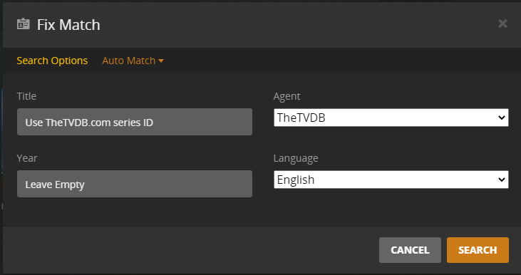

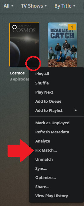

Move your mouse over the show poster for Show 2. Click on the three vertical dots in the lower right corner. Select Fix Match from the menu.
In the Fix Match window, use the series ID from TheTVDB.com instead of the show name. Leave the date empty.
It should match things correctly, then combine them into one listing.
I tried that numerous times but still remained separated. Just tried once more and now it only brings up 9-1-1: Lone Star and it changed the main title to 9-1-1: Lone Star but all the covers for each season are for 9-1-1.
