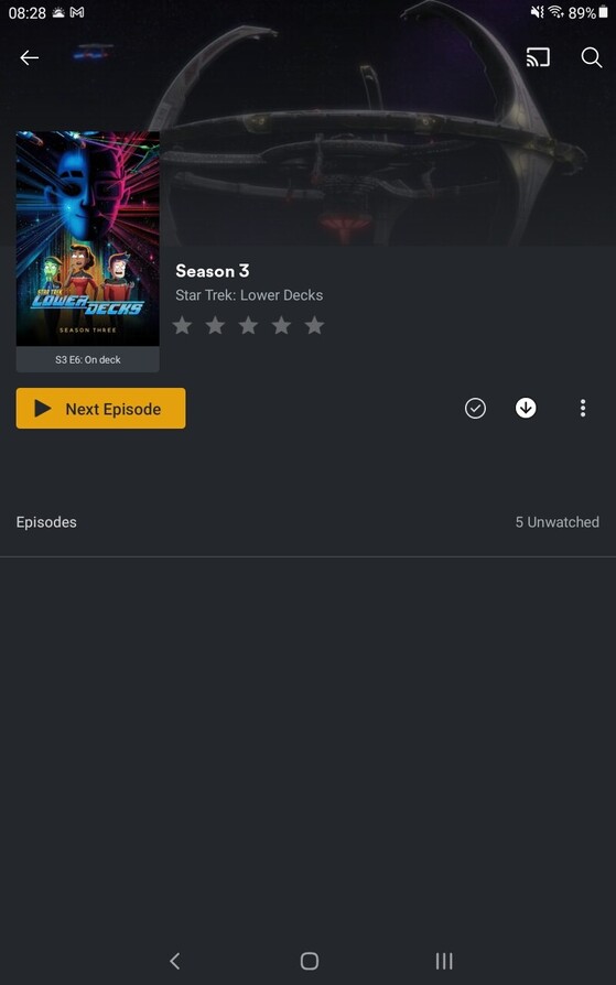

We don’t watch much on tablets or phones but this problem certainly has been happening for a while now and is NOT a new issue. However, IMO its now much worse now, especially on tablet (Galaxy Tab A).
Steps to repro are easy (at least for me):
  • Select any TV show from continue watching home hub.
  • Once at the pre-play screen then select the three dots on the right and select go to season.
Result: No episodes are shown, screenshot below.
This also happens on mobile but appears far less. Also, on mobile killing the app, clear cache and restarting fixes the issue. THIS DOES NOT WORK ON THE TABLET.
Logs can be supplied upon request from development. I’ll not be uploading them publicly.
EDIT: Looking in the log myself this happens RIGHT AT THE FAILURE WITH THE TABLET CLIENT:
05-31 08:27:43.584  i: [UpdateChannelsJob] Adding program for item Star Trek: Lower Decks with uri plex://server://xxx/com.plexapp.plugins.library/library/metadata/7298?asyncAugmentMetadata=1&checkFiles=1&includeExtras=1&includeReviews=1&playbackOrigin=AndroidTV%20Channel.
05-31 08:27:43.587  i: [UpdateChannelsJob] Adding program for item Star Trek: Lower Decks with uri plex://server://xxx/com.plexapp.plugins.library/library/metadata/7298?asyncAugmentMetadata=1&checkFiles=1&includeExtras=1&includeReviews=1&playbackOrigin=AndroidTV%20Channel.
05-31 08:27:43.590  e: [UpdateChannelsJob] Unable to insert program due to Failed to insert watch next program : the app already has max number (8) of programs created.
05-31 08:27:43.592  e: An exception occurred: java.lang.IllegalStateException: Failed to insert watch next program : the app already has max number (8) of programs created.
05-31 08:27:43.593  e: [UpdateChannelsJob] Unable to insert program due to Failed to insert watch next program : the app already has max number (8) of programs created.
05-31 08:27:43.595  e: Stacktrace: java.lang.IllegalStateException: Failed to insert watch next program : the app already has max number (8) of programs created.
