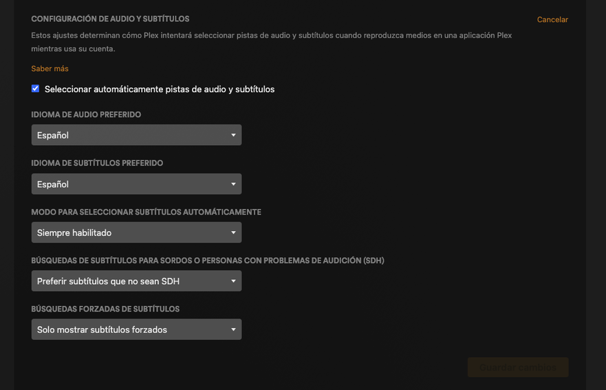

This my subtitles configuration.
What I need is for content in Spanish (because I am Spanish) to show forced subtitles in Spanish to be able to read what the forced subtitles are typically used for: translating the text of an image that appears on the screen or when a person speaks for a moment in another language and it comes out subtitled.
What I don’t want is to see all the text of people speaking Spanish when I understand it perfectly as it is my language but for it to be shown because plan A is the forced ones if it exists and plan B is the “normal” ones if the first one does not exist.

You need to change the subtitle mode from “always enabled” to “shown with foreign audio”.
But this is only half the way.
You actually need to have those forced subtitles with (or inside) your files, properly tagged as “forced”.
Plex cannot extract only the “forced” lines out of a stream of regular (“full”) subtitles.
It is also pretty rare to actually find forced subtitles on opensubtitles.org, so don’t expect them to be available.
And this automatic selection will only work on videos where you did not previously select a different subtitle manually.
Okay, that’s what I want.
If the file has forced subtitles (because you have to translate something on the screen or a phrase that is done in another language, well) and if it does not exist in the forced file, nothing happens, don’t show anything and that’s it.
It seems that that option in 2 or 3 that I have tried works by setting the option to show with foreign audio.
Where it was forced, it shows them at the necessary moments and where they do not exist, it does not show anything instead of showing the text of all the dialogues (which I do not want).
