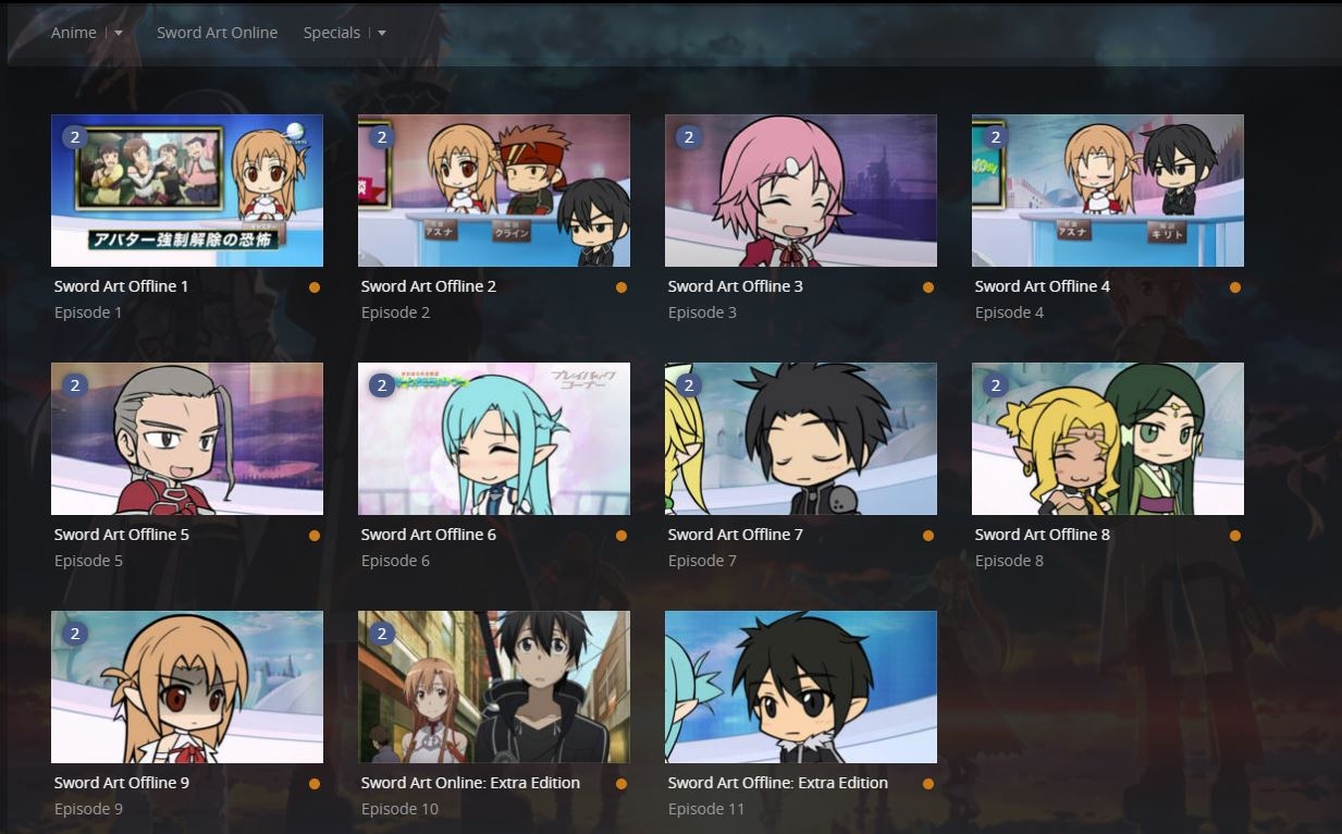

@ZeroQI - Looking good! I updated the scanner code, deleted the “anime test” library, and recreated it with SAO again. Looks like all the specials mapped correctly now and SAO Season 2 specials are being offset properly!
In case you wanted to look at anything or verify, here is the scanner logs. (forgot to del them before running, so not quite fresh/clean but I’m sure you’ll be able to see where the scanning with the updated scanner happens, just a few minutes ago just after 14:00 I think.)
Just took a peek and I do still see the exception errors though too and mappingList with empty offset, which is odd?? That just artifact of old code that needs to be cleaned up?

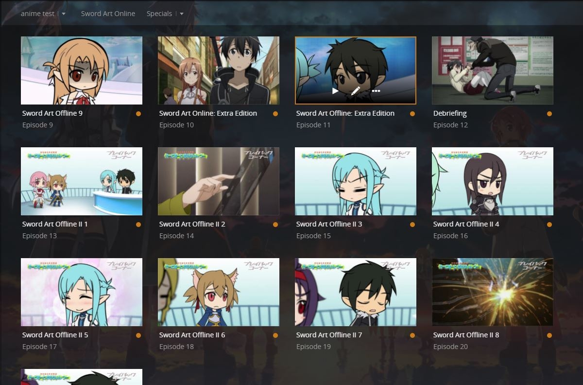

@ZeroQI - I loaded the new code into my v2 scanner, deleted library and logs to clear them out, and then went to recreate it. Unfortunately something happened though I think that broke it. The library is showing up empty and no scanner or filelist log is being generated. =/ Not sure where else to check to see why it isn’t working. I did go in to the scanner v2 file and verify I had copy-pasted correctly, and the beginning and end few lines match what is on the github link.
edit: Just a quick update to say that I did go back to my old/main “Anime” library that is still running the original ASS (not v2) and had it do a scan. As soon as I did both the SAO and main ASS logs were created from running that scan, so definitely seems something with the latest update to the v2 code and not something on my system.
@deusxanime didn’t like the for inline dunno why
for string2 in season.text.split(’;’):
mappingList[ ‘s’+season.get(“anidbseason”) + ‘e’ + string2.split(’-’)[0] ] = ‘s’ + season.get(“tvdbseason”) + ‘e’ + string2.split(’-’)[1]
please try: https://raw.githubusercontent.com/ZeroQI/Absolute-Series-Scanner/ZeroQI-patch-1/Scanners/Series/Absolute%20Series%20Scanner.py
@ZeroQI - This time it did create the library and proper logs. I’ll attach them here.

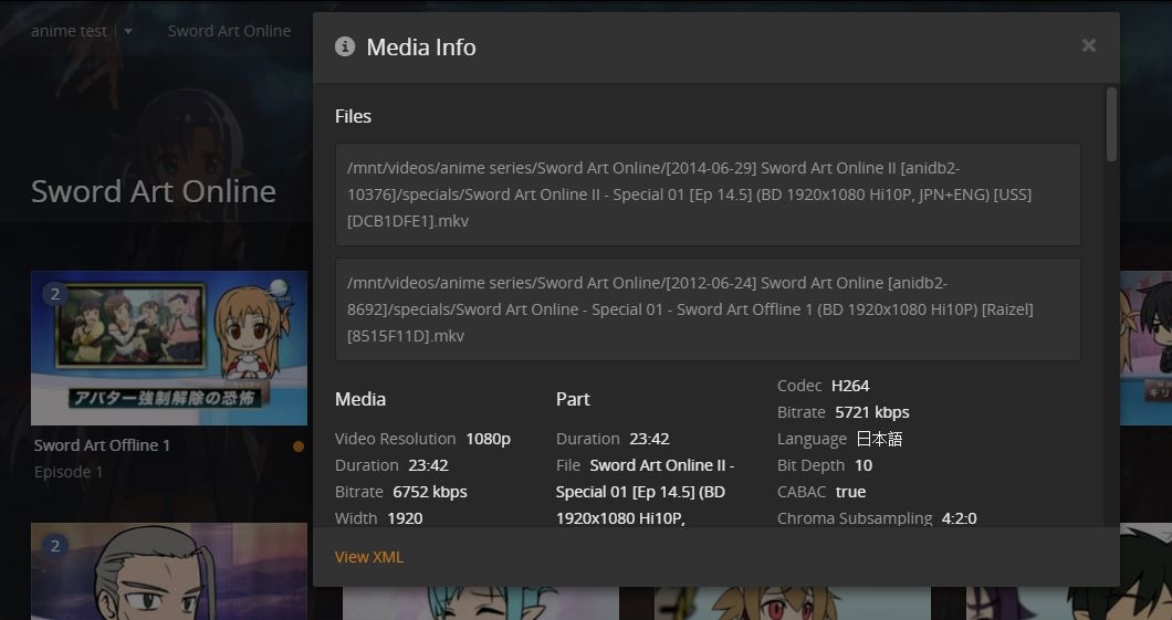

It looks like something is still not quite right though because the “Extra Edition” episode and special mapping isn’t correct now and just dropped them as s0e01.
@deusxanime : passed all day on it. no more errors reported and works
https://raw.githubusercontent.com/ZeroQI/Absolute-Series-Scanner/0a0ff585c1f8af57a38c5c41e8a839f81fc53179/Scanners/Series/Absolute%20Series%20Scanner.py
Please confirm it works and will merge in master code
@ZeroQI - Initially it came up as 2 separate entries, but unmatch and rematching caused them to merge properly into a single SAO entry. Unfortunately looks like the specials are mapping all wonky now. The SAO season 1 specials seem to just have gotten lost and the season 2 specials mapped to s0e01+ rather than higher up.
@deusxanime : getting there, forgot the line to apply offsets, was to focussed on getting it not to crash
https://raw.githubusercontent.com/ZeroQI/Absolute-Series-Scanner/bc8b0996e1cb566c799845e7893f7d18264550bb/Scanners/Series/Absolute%20Series%20Scanner.py
