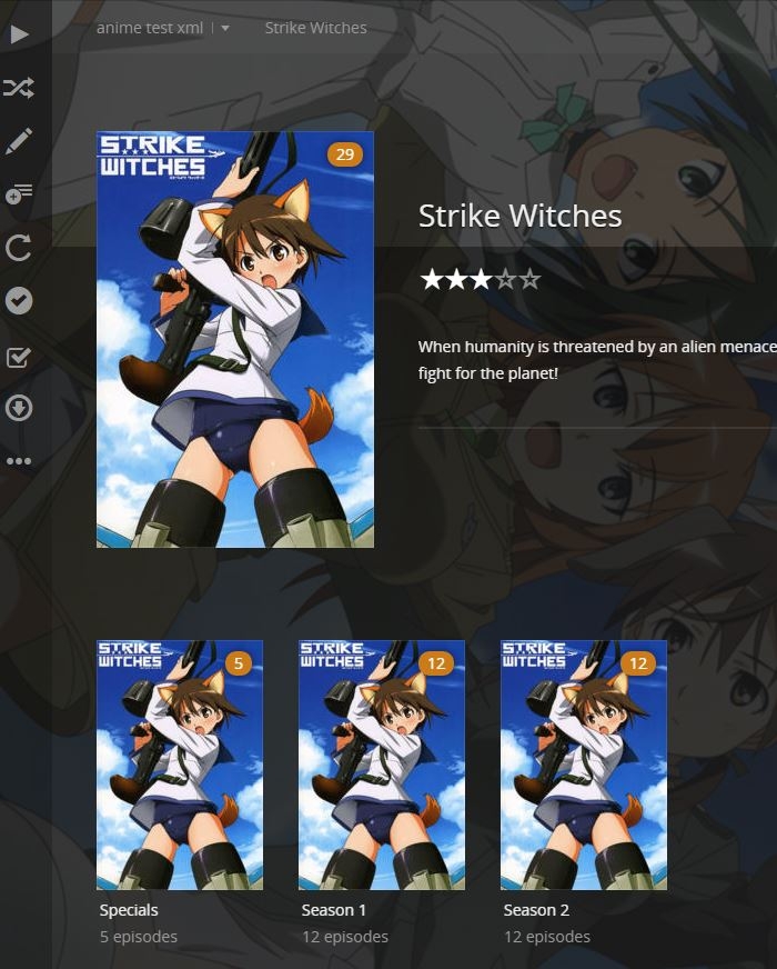

@ZeroQI - Here’s what I did for Strike Witches, let me know if I got any part of this wrong
I have 5 folders/series for SW, 3 of which have incorrect mappings in the ScudLee xml. For the ones I had “fixed” this previously using [tvdb-XXXX-sXeY] tagging, I switched them back to [anidb2-XXXX] tags in the folder name.
[2007-01-01] Strike Witches [tvdb-82484-s0e1] => [2007-01-01] Strike Witches [anidb2-4530]
[2014-09-20] Strike Witches - Operation Victory Arrow [tvdb-82484-s0e3] => [2014-09-20] Strike Witches - Operation Victory Arrow [anidb2-10198]
The others were already using anidb2 tags. For the 3 that I want to override, I put a custom xml file in each series folder.

I updated ASS using the link you provided in the previous post (this raw link). To be sure I also updated HAMA to the latest master, which looks to be from yesterday.
I cleared out all the logs, then created a new test library with the SW folder as root and ASS/HAMA of course as scanner/agent.
It looks like I did something wrong though as the library didn’t seem to match anything. They are all showing up as separate entries with no match or metadata.
Attaching logs of filelist, ASS, and HAMA also. (For some reason the filelist didn’t append the library or root folder name). Obviously it seems like I missed something or didn’t understand where to put files, so let me know.

Thanks @ZeroQI. So it sounds like my placement and formatting of the custom xml files was ok and this was just a bug in the scanner?
@deusxanime honestly you documented so well i just reproduced your folders, then worked on the code, all was good on your side, but it’s kinda complex for the scanner, then even if i fix at times have to recreate the library since it won’t rescan since nothing changed in the folder, and if there is an error, it doesn’t always displays it
 it is longer than with the agent to fix things
 Had 20 minutes at lunch and managed to solve few issues, i used the code i was working on and look like it’s good. Lucky since yesterday i passed 3 hours to get to a non workign scanner with no error message
Managed to spot few issues,:
  • had eps showing as season 2008
  • put as relative path the filelist
  • fixed mapping, defaultseason 0 caused issues.
https://raw.githubusercontent.com/ZeroQI/Absolute-Series-Scanner/0277dcc4392b22237fac7a9d0f2ebe06ca46ed52/Scanners/Series/Absolute%20Series%20Scanner.py
Tell me what you think: (copy in notepad or notepad++)

@ZeroQI - Looking good! All I did was update the scanner to the newest one you linked (no changes to xml files content or locations), and SW all went in correctly from what I can see. The only thing still not quite working right is the filelist output does not include the root folder or library name, it just is blank (as you can see from the filename of the attached filelist).
Attaching logs also in case you want to see them. Next I’ll probably give SAO a turn to see if any issues loading with correct mappings, though I don’t think there are any custom mappings needed, wonder if I’ll still get the issue where specials are number correctly but ordered wrong. Also SAO S2 has offset mapping rather than direct episode-to-episode, so a good test of that.
Still have issue with season art not loading right also, as you can see in the screenshot all seasons just use the series art. Going to try to delete all anime/ass/hama libraries and see if that will clear out corruption or whatever is causing that.
I deleted all ASS/HAMA related libraries in Plex and then cleaned bundles/empty trash/optimize db to try to clear out anything that might have been cached, and then recreated my test library, but still getting the issue where seasons don’t load their artwork. =/ Next step might be to delete HAMA directories completely and then redo the agent, if you think that might clear out the gremlins?
Also, looks like an issue/regression still with SAO mapping, specifically the Extra Edition episode and special. ScudLee github master xml file looks correct for this one, so I didn’t add any custom mapping xml to it. Here’s what is in there for SAO EE:
  <anime anidbid="10022" tvdbid="259640" defaulttvdbseason="0">
    <name>Sword Art Online: Extra Edition</name>
    <mapping-list>
      <mapping anidbseason="0" tvdbseason="0">;1-11;</mapping>
      <mapping anidbseason="1" tvdbseason="0">;1-10;</mapping>
    </mapping-list>
  </anime>
But the SAO EE special is mapping to s0e10 (same as main movie), rather than to s0e11 as it should.
I deleted all logs before starting so they would be clean and easy to read. Attaching logs and filelist again for you to look over. Oddly there is no “com.plexapp.agents.hama.log” file under the “PMS Plugin Logs” directory. Is this because the series are being mapped to TVDB and HAMA isn’t actually being used?
Sorry for yet another post, but I got ansy and ambitious and I tried deleting the all ASS/HAMA libraries, then the entire HAMA Data and Caches folders, recreated the necessary folders (TVDB and subfolders, TMDB, etc), restarted Plex just to be safe, and then tried to set it up again along with a library.
Still no go and not downloading season artwork (and maybe others?). The artwork should be going in the TVDB/posters and other directories correct? After creating the library it almost seems like stuff isn’t being written to them as they are still all empty, if that is where they are supposed to go to. I have verified the account Plex runs under “mediapc” has full rights to the directories.
