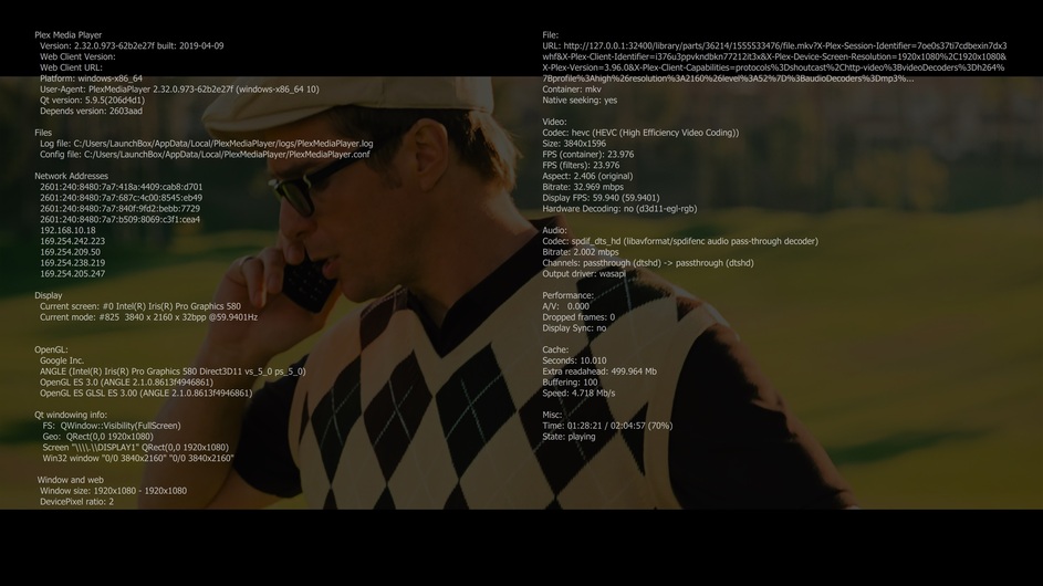

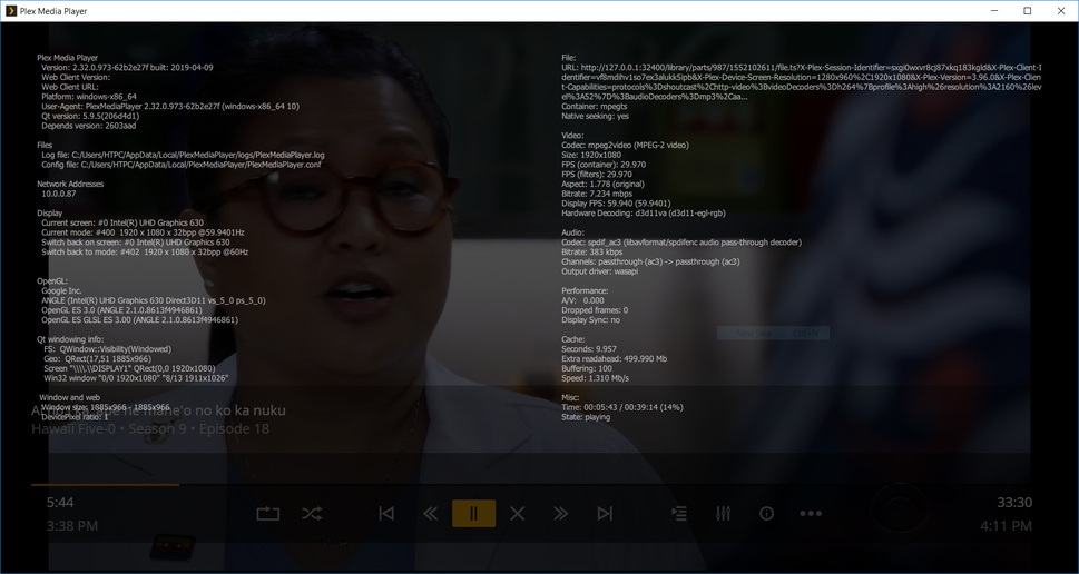

Can you play something, and during playback, bring up the debug overlay by pressing I, and take a screenshot of it please?
Two screen shots attached. From two different TV shows.
Here are mine aswell
What i dont understand is why it calls it spdif-dts-hd when i am not even using that port. I run pure HDMI. And yes my cables are HDCP 2.2 HDMI 2.0.
