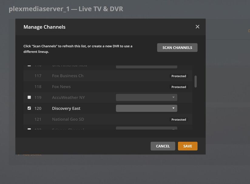

Then I go to plex, add the HD Homerun as a device, it finds my channels, asks me to select the channels (which I select all - 391 channels), but it only pulls in a few. I actually have been able to pull in 27 channels of the 391.

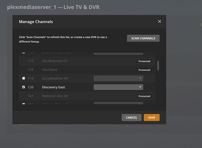

On the far right on that first screenshot you will sometimes see the word “protected”. Those are the channels that you cannot use with Plex.
For the rest of the channels that do not indicate protected, you tick the checkbox on the left and then Plex will use those channels.
It also looks like you haven’t selected the correct guide, because those drop downs next to the unprotected channels should have the corresponding channel name. Can you manually click on the drop-down’s and select the correct channel?

So I try to, but for example, I have CNN, but I do not see the corresponding option for CNN in the drop down.

I think what originally happened was that I created the channel guide based off my OTA aentenna, and then added the cabel card. Now, deleting everything, it allowed me to start it from scratch, and get all the cable channels instead.
