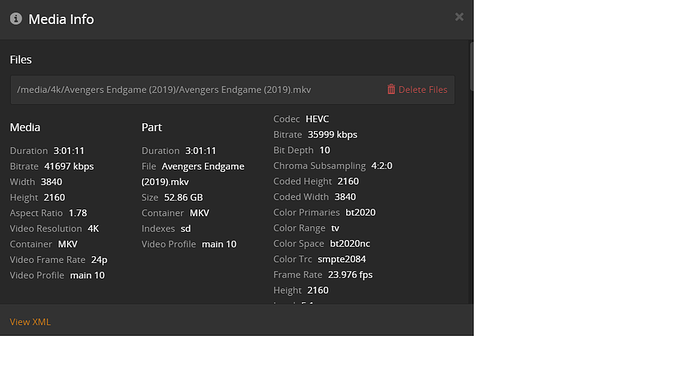

It appears the scanner/media analysis only looks at the width and height of the media to determine the aspect ratio of the movie. However, in the case of 2.4 aspect ratios, which include black bars, that differs from the actual film’s aspect ratio.

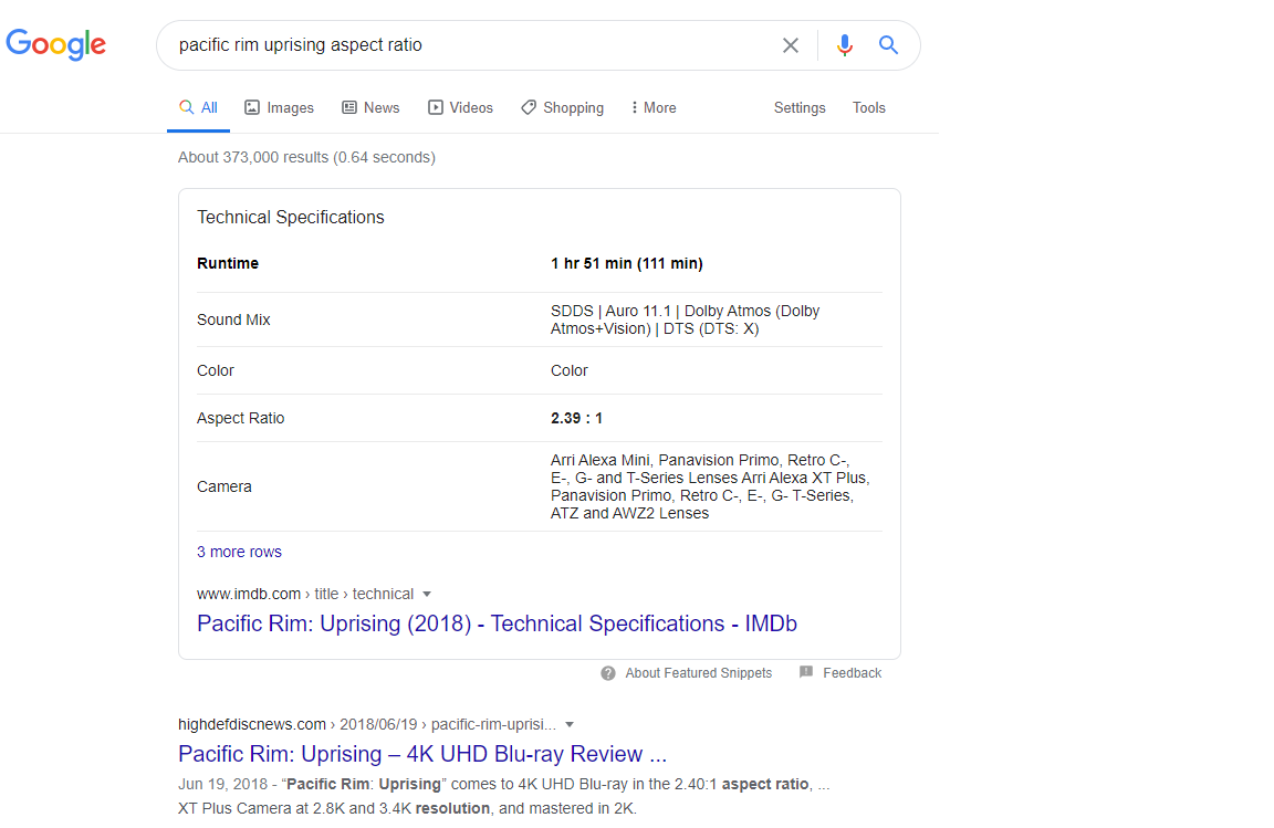

If the scanner/media analysis can be adapted to determine the aspect ratio of the film, that would be great. But it seems like it would be much easier to just grab the aspect ratio provided by the IMDB, when gathering things like plot, tag lines, etc. The former seems like it would take a great deal of time to implement, and more prone to error.
Here is an example of a 1080p and 4k remux for the same movie.

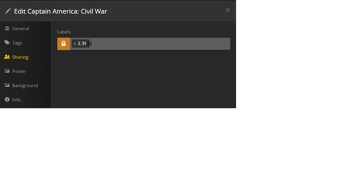

How do fix it, I can’t really. What I have done is create a workaround. I manually use Labels within the Sharing tab to indicate the aspect ratio of the film.
Then I use that data in my automation to set the projector’s aspect ratio. (Tautulli, MQTT notification, Home Assistant, Harmony Hub IR, Projector.)
Kind of convoluted, and some day if aspect ratio of the film was correct in Plex, AND Plex exposed the aspect ratio in the webhook (both of which are not true today) I could bypass a great deal of that workflow.

But there is no theory when determining the aspect ratio of the film (not the media file.) The film’s aspect ratio is a known quantity. The first result from google pulls the info from the IMDB.

Your solution with labels is clever and I think it’s your best bet overall. It wouldn’t be that hard to use the IMDB/TMDB APIs to request this info, but I think you’d still want to validate it.

The bars are the problem. Plex has no concept of these bars are. It just knows there are pixels, so it uses them according to what it’s told from the rest of the file.

It’s not broken. Plex is detecting what is in the file. If you encode a file with black bars, it’s not like there is something in the file that says, hey these are black bars ignore them.
Plex also looks at more than just the resolution. When encoding a file, there is also a parameter known as the pixel aspect ratio. Plex uses this to determine the aspect ratio the display should be and will scale correctly. For example, I have files that I’ve cropped the bars off so the file is 1920x803 with a pixel ratio of 1:1, giving an aspext ratio of 2.39:1, which will play correctly. I also have files that have 1920x1080 resolution with a pixel ratio of 4:3 making it 2.39:1 overall and also play correctly.
The problem is the bars. Most Plex players cannot just ignore these bars. The Plex Android app is able to fill a screen which will push the bars off the screen, but other Plex clients can’t do that.
