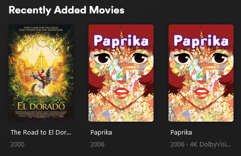

Yeah, I add edition tags on them, because otherwise you can’t tell the difference between them on the main screen hubs that combine items.

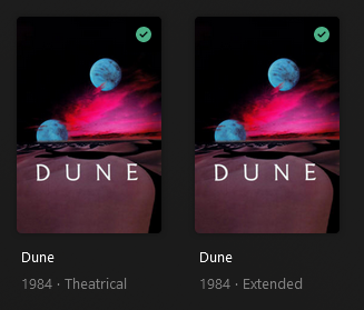

I mean, I do tip my hat to you, as you have solved the mystery here… I just looked at Kyle MacLachlan’s page:
…and it’s missing the two copies of Dune I have:
Screenshot 2024-04-15 at 05-18-22 Plex
So essentially, Plex’s Editions feature and the Discover feature are incompatible with each other!
