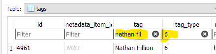

  • View tags table
  • Actors have a tag_type of 6
  • Search for the actor you want in the tag field
  • Get the id of the field

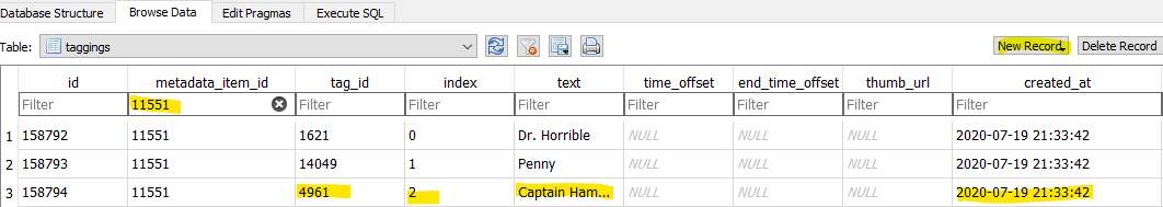

Add to taggings:
  • Open taggings table
  • Type the movie id in the metadata_item_id
  • Click the New Record button
  • Type in the tag_id
  • Index field is a sequence, enter the next number
  • Text is the character name
  • Created_at field is a timestamp that can be copied/pasted from another record
