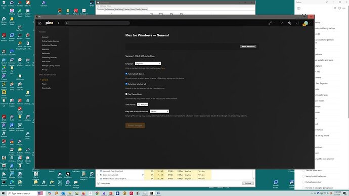

I just downloaded the media server yesterday, so I would assume it’s the latest version. I installed it and it is running. The screen shot is the Plex windows app/settings which I also downloaded yesterday.
That is not showing yours server settings. So likely the server either isn’t claimed or is claimed by another account. ( I don’t see it in task tray but possibly hidden or just not running)
What you have there is “Plex for Windows”, a Plex client app.
Verify that you have downloaded and installed “Plex Media Server”.
When Plex Media Server is running, it will be represented by a Plex icon in your task tray.
Thanks. I had Plex Media Server running, but did not sign in with it. I did not realize that there was an icon in the task tray. It was in the overflow area accessed by clicking the ^. I think I have everything working now. Thanks to all for the help.
