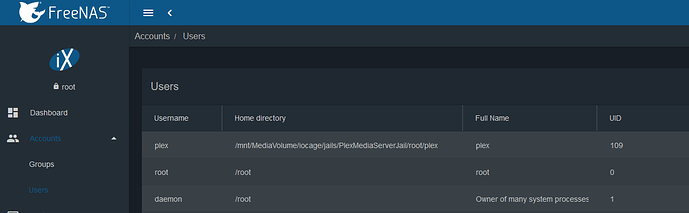

From the looks of things, the User ID for the ‘plex’ user is 109, and the group ID is 114. So I set about creating a similar user and group within FreeNAS:
Having set up the user and group, I still can’t get Plex to see any of the files on the FreeNAS server.
