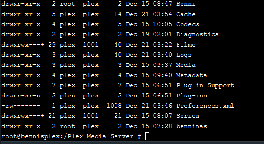

So I recently did setup plex with FreeNas, I had the same Problem that it was grayed out.
I went into the shell of the jail to the “Plex Media Server” folder where my media folders where mounted, then I changed the user for these Folders manualy.
For your example that would be:
chown -R plex:plex mymedia

I think it makes sens to navigate to the Folder and check who ownes these Folders in you Jail.
As you can see in my Screenshot the Folder that were created when adding the mount point to the jail where created not by plex but by ‘1001’ and before I went in to change the user the field right in front where it now states plex where also assigned to ‘1001’ instead of Plex:
