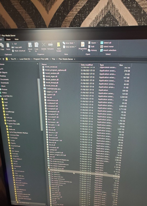

I cant find a folder named updates??
Can you show me the path?
Please follow the link to the Plex data folder
This is the Plex program folder. You want the Plex data folder, which can be found under C:\Users\<username>\AppData\Local\Plex Media Server
