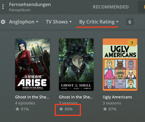

I have configured my library to use the TheTVDb agent and all my shows got a critic rating (usually showing as a percentage on the show and episode level).
Here’s an example:
  1. TV Show w/ critic rating on the library page

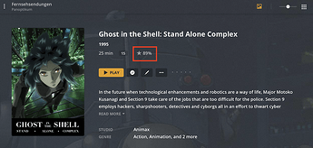

  2. TV Show w/ critic rating on the show’s details page

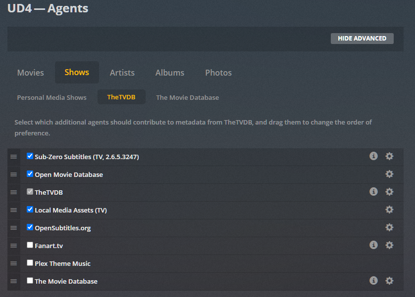

@tom80H, Thank you again for your explanation. That makes sense now. I made sure that I selected TheTVDb for shows, unchecked “Open Movie Database” and changed the order. I now have this:
(Is this the “best” priority order to get the Show ratings?)

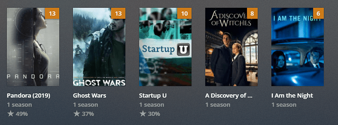

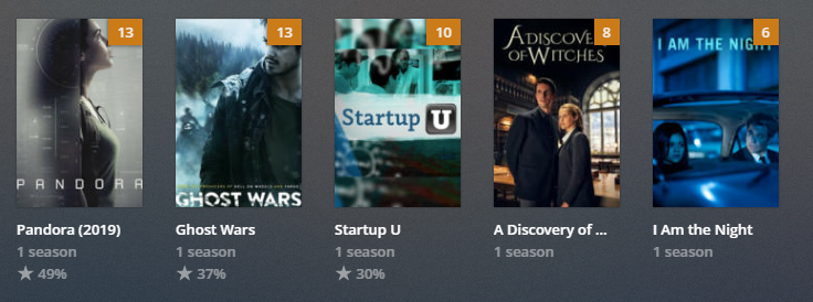

Many shows then got ratings but they were still missing for 10 shows. I had to manually refreshed the Metadata for those shows and it worked for all but 2 shows (sorted by critics rating):
Not sure why it fails for those 2?

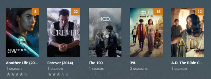

If I sort by “rating” instead, only two shows have a “rating”:
Thus, it appears that the agent mainly pulls “critics rating” rather than “rating” except for those 2 shows?

as for #1-#3
  • critic rating (or audience rating which is currently also available for movie libraries) is the rating Plex obtains from its online sources.
  • rating is the rating you assigned to a show / season yourself.
