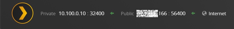

Sorry, I’m not a networking expert so it’s beyond what I can help with but it sounds like something is not configured properly. When looking at the remote access page, do you see your local IP listed there? If not, that’s a good indicator something is wrong.
That looks perfectly normal, disabled and re-enabled multiple times just to make sure that remote access is working as expected.
