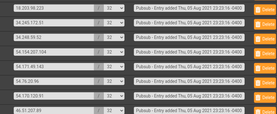

Here, I don’t know how current this list is.
This is the list I have and PMS likes it.
I always get instantaneous “Remote Access”.
The biggest problem I encounter with folks is
  1. They’re using UPNP on a modem/router which has a FULL UPnP Tabl
  2. They manually forwarded TCP from WAN to 32400 on the LAN –
    But forgot to open the port on the host.
This list might be completely out of date – :person_shrugging:
Caveat Emptor
