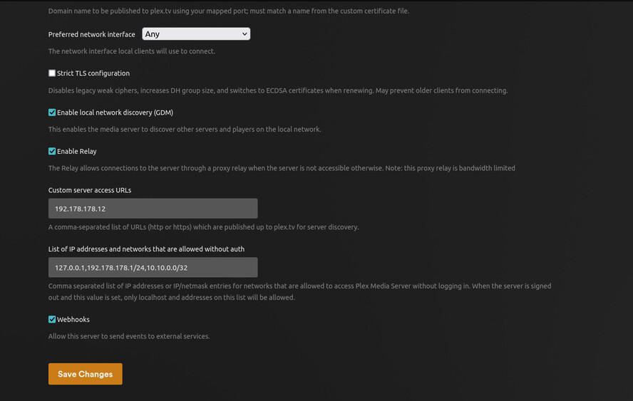

127.0.0.1,192.178.178.1/24.
What part of the settings you need? there are many tabs in the settings menu.
ps, the last interface belongs to a VPN connection. For now please ignore it.

Ah ehm yes try changing
to
192.168.178.0/24
and remove everthing else.
Localhost (the 127.0.0.1) shouldn’t be necessary and 10.10.0.0/32 doesn’t seem right. /32 means no further IPs (all 32bits are fix) and any *.0 seems to not be used for any clients afaik, which is why your router, the very first device in your network, gets a *.1. And maybe Plex just refuses access from all IPs in the allowed fields if a single entry is off.

  1. you can’t authenticate locally. User accounts only exist on plex.tv
  2. remove the space character after the comma in that input field. Otherwise the whole field will be ignored.
    If you put your whole local network in there, then nobody is forced to authenticate. If you’re unlucky, all clients will be treated as if they were logged in to your “admin” account.

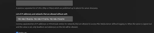

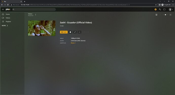

Ehm excuse me? I use Plex without logging in??
just typed in the ip and voila! Things are going great for me. And I just whitelisted my ip range.
Edit: yes, I just read a bit further and I assume that most people know who uses their LAN and that these people are not raiding the server, which makes this option good enough for these people. I also assume that when OP asked for general access without authorization he knows that they might do so - without authorization.
And it’s also merely the subnet, not the whole internet. FritzBox has fancy tech like a guest hotspot, securing the LAN from those mischievous people even more.
