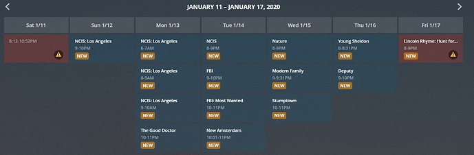

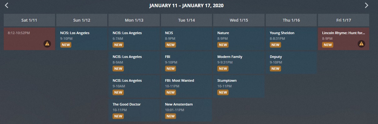

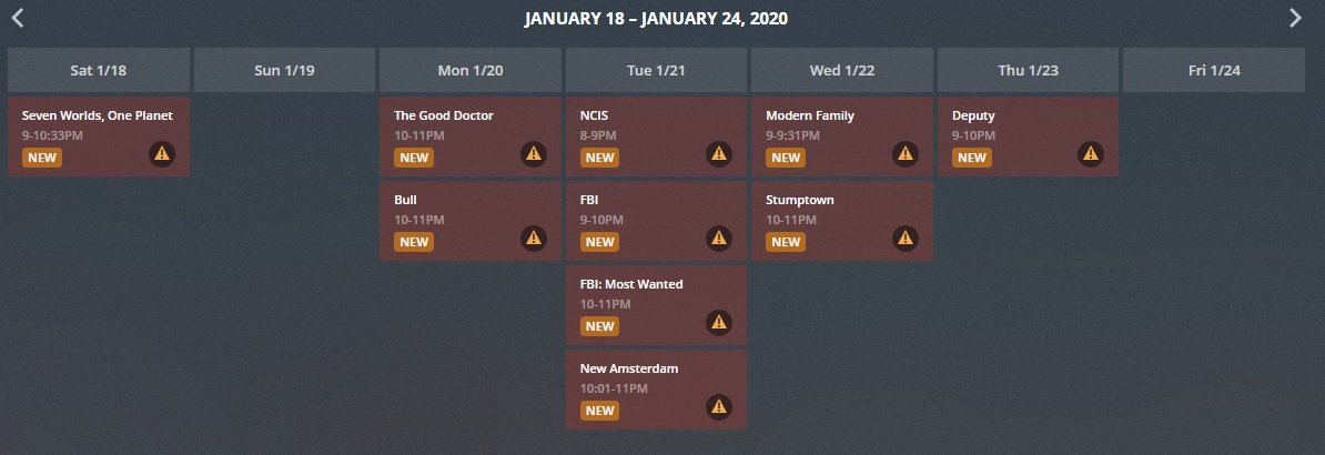

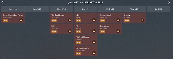

This started on the 17th when I installed version 1.18.4.2171. See attached screenshots:
